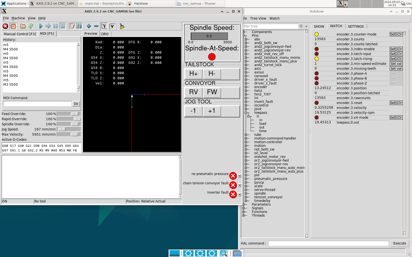

I need a little help, I can't get the spindle speed in rpm.
I have a 1024 pulse/revolution encoder on the spindle
The encoder A phase is connected to the hm2_7i97.0.7i84.0.0.input-28
The encoder index pulse is connected to the hm2_7i97.0.7i84.0.0.input-30
I have the impression that my encoder transmits the pulses correctly, but the value of low.pass.0.out and encoder.0.velocity-rpm is not fixed and displays values from 3 to 19 for a rotation speed of 500 RPM.
what do I need to change ?

# Axis: SPINDLE Joint: 5 Output: 5
setp pid.s.Pgain [SPINDLE_0]P
setp pid.s.Igain [SPINDLE_0]I
setp pid.s.Dgain [SPINDLE_0]D
setp pid.s.bias [SPINDLE_0]BIAS
setp pid.s.FF0 [SPINDLE_0]FF0
setp pid.s.FF1 [SPINDLE_0]FF1
setp pid.s.FF2 [SPINDLE_0]FF2
setp pid.s.deadband [SPINDLE_0]DEADBAND
setp pid.s.maxoutput [SPINDLE_0]MAX_OUTPUT
setp pid.s.error-previous-target true
net spindle-index-enable <=> pid.s.index-enable
net spindle-enable => pid.s.enable
net spindle-vel-cmd-rpm-abs => pid.s.command
net spindle-vel-fb-rpm => pid.s.feedback
net spindle-output <= pid.s.output
# ---PWM Generator signals/setup---
setp hm2_[MESA](BOARD).0.pwmgen.05.scale [SPINDLE_0]OUTPUT_SCALE
setp hm2_[MESA](BOARD).0.pwmgen.05.output-type 1
setp hm2_[MESA](BOARD).0.pwmgen.05.offset-mode 1
# ---Encoder feedback signals/setup---
setp encoder.3.position-scale [SPINDLE_0]ENCODER_SCALE
setp encoder.3.counter-mode true
net spindle-position encoder.3.position => spindle.0.revs
#net spindle-velocity encoder.3.velocity => spindle.0.speed-in
setp scale.0.gain 60
setp lowpass.0.gain 1.2
net spindle-velocity-rps encoder.3.velocity => scale.0.in
net spindle-velocity-rpm scale.0.out => abs.0.in
net spindle-velocity-rpm-abs abs.0.out => lowpass.0.in
net spindle-velocity-rpm-abs-filtered lowpass.0.out
net spindle-index-enable encoder.3.index-enable <=> spindle.0.index-enable
net spindle-phase-a encoder.3.phase-A <= hm2_7i97.0.7i84.0.0.input-28
net spindle-phase-b encoder.3.phase-B
net spindle-index encoder.3.phase-Z <= hm2_7i97.0.7i84.0.0.input-30
net spindle-vel-cmd-rps <= spindle.0.speed-out-rps
net spindle-vel-cmd-rps-abs <= spindle.0.speed-out-rps-abs
net spindle-vel-cmd-rpm <= spindle.0.speed-out
net spindle-vel-cmd-rpm-abs <= spindle.0.speed-out-abs
net spindle-enable <= spindle.0.on
net spindle-cw <= spindle.0.forward
net spindle-ccw <= spindle.0.reverse
net spindle-brake <= spindle.0.brake
net spindle-at-speed => spindle.0.at-speed
# ---Setup spindle at speed signal
net spindle-cw => hm2_7i97.0.7i84.0.0.output-05
net spindle-ccw => hm2_7i97.0.7i84.0.0.output-06
net spindle-output => hm2_7i97.0.pwmgen.05.value
net spindle-enable => hm2_7i97.0.pwmgen.05.enableAttachments:

You would normally use a 7i97 encoder for this:
net spindle-vel-fb-rps <= hm2_[MESA](BOARD).0.encoder.05.velocity
net spindle-vel-fb-rpm <= hm2_[MESA](BOARD).0.encoder.05.velocity-rpm

thank you, it works perfectly except for the spindle speed pyvcp and spindle at speed led, which do not work.
in halcmd spindle at speed work.
in which file are they affected, i created my config with mesact ?

I'm no pyvcp expert but I don't see any connections from
spindle-at-speed or the actual spindle speed to pyvcp pins
