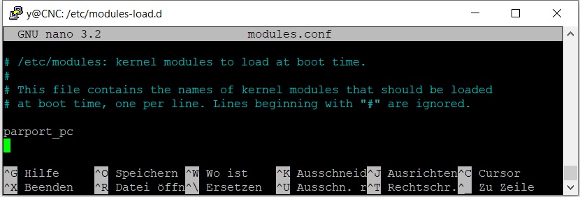

Since I want the ports to be active when the PC boots up instead of when LinuxCNC starts,
I decided to enter the configuration of these in any existing *.conf file in the etc/modprobe.d directory.
This is easy to do, the "*.hal" remains untouched, which is what I personally prefer.
lspci -v is an important command, it provides data, but only shows the presence of the computer components,
not whether they are sufficiently configured.
Whether it was due to the "problematic" PCI cards or the swapping of the kernel,
the problem was that the module for the parallel ports was not loaded in the kernel.
lsmod provides information about which modules are loaded, "parport_pc" was not there.
I don't know if there is a simpler or even the right solution,
it works for me and maybe it will help others with the same problem.
Remedy: sudo nano /etc/modules-load.d/modules.conf
Entry: parport_pc
Reboot system
