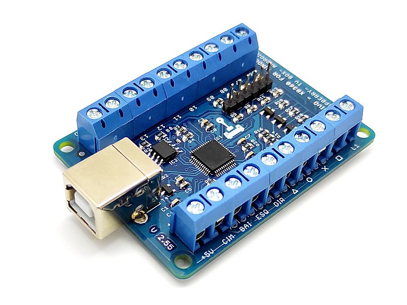

Hello Mates,
Im quite new with LCNC, forgive me if this topic is repeated.
I was watching this video on utube about classicLadder, using a game pad as Jog Pendant and got me thinking if would be possible to use those cheap "zero delay usb arcade controllers" as panel input, I believe it IDs as a gamepad on USB, right?
Anyone had experience?

Anything that identifies as any sort of USB-HID can be used with the hal_input component. So these should work.
Be aware that USB-HID (in fact all USB) happens in the userspace layer, no realtime response can be guaranteed. (Don't try to use it for E-Stop)
