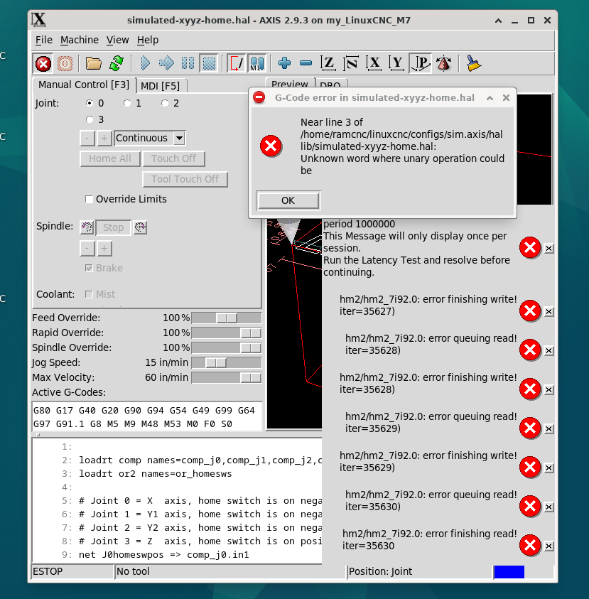

Team,
I need some help. New to linuxcnd. Linuxcnc bookworm on N97 CPU, Mesa7i92TF, fails to launch.
Error "Unexpected realtime delay on task0 with period 1000000"
hm2/hm2_7i92.0 erro finishing write! iter=2219.
i did update the driver r8168kdms, disable cpu power saving mode , set - c state at level 2. Please

It looks like you are running a non-realtime (sim) configuration

do you have a good configuration for realtime sim config ?

AFAIK Sim is non-realtime by definition

I m stuck - can you give me an sample of config for real time.
i have mesa 7i92TF - Gecko540
