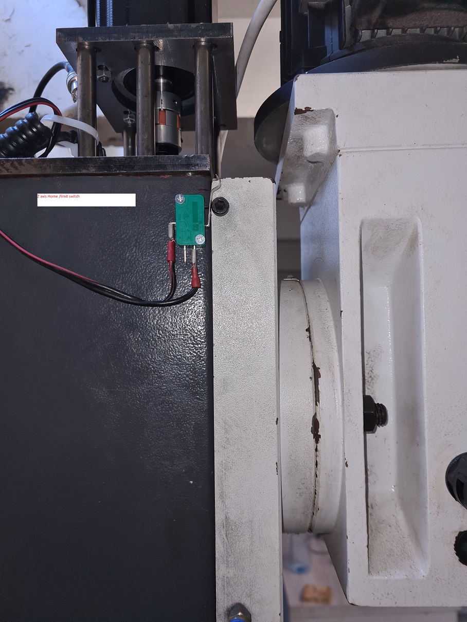

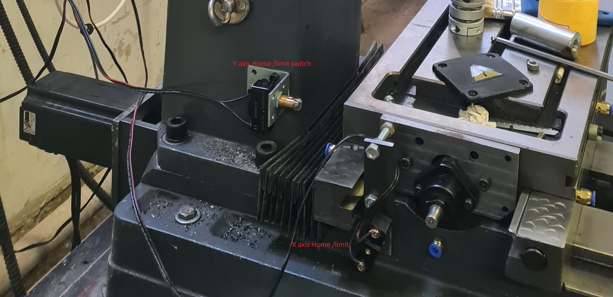

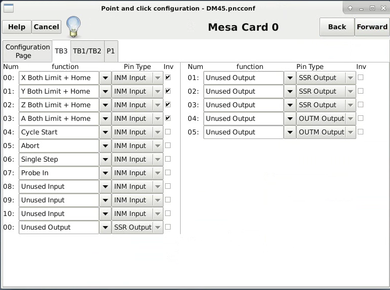

I use same input for home and limit switch  on all axes .
You see in the where are the switches:
What I want to do is when lets say homing Z - goes to the switch trips it, returns slowly trips it again and then moves 10mm down. Ini file is attached check it and tell me what I am doing wrong.

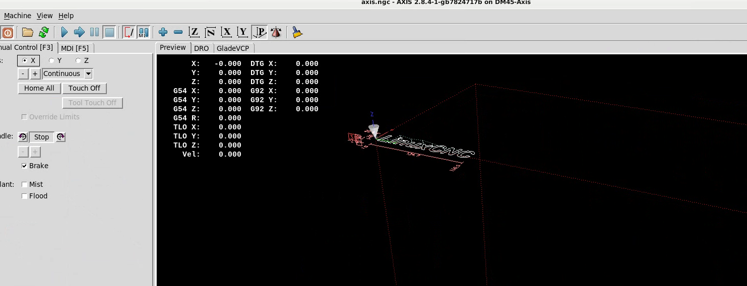

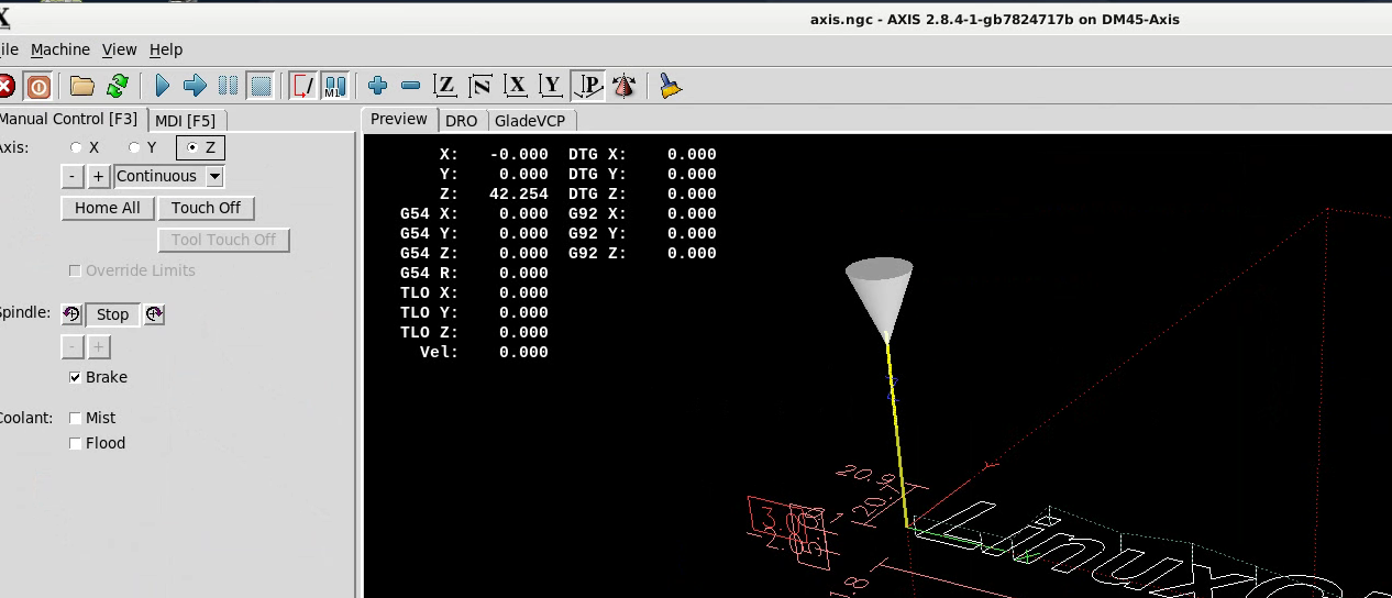

When up jog up:
Same thing with homing : It go up fast click returns slow click and goes above the switch.

Note that Home switches must stay triggered to end of travel. Are yours doing this?
