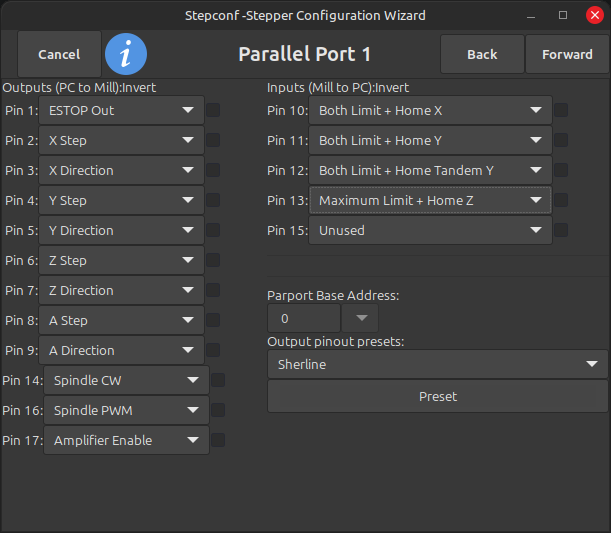

Hello there!
I have recently mostly finished my CNC mill. It is a 3 axis moving gantry, with two motors on the Y axis.
After lots of troubleshooting and learning about linuxcnc, I finally (!) got all 4 joints to home.
I can jog X and Z as I should be able to, but with Y that's a different story: only one of the Joints moves during jogging.
After only implementing the 4 joints and declaring joint_1 and joint_3 as Y in the ini didn't work, I tried adding loadrt gantry [.....] . The syntax with this one is a hassle. About 3 hours later I got linuxcnc to post with it, only to find out that it didn't change anything at all.
I can later (got them on a thumb drive right now) post my .hal and .ini if that helps. Maybe someone knows an answer already.
Thanks to you all in advance!

Need some more info:
-parallel port or Mesa or something else?
-where did you get the info about loadrt gantry thing?

Parallel port +bob. Mesa was too expensive for me for a proof of concept.
I found the gantry command (if it's called that) in the linuxcnc documentation, and thought that it might solve the problem.
Thing is: the problem stands with or without loadrt gantry. All the axis home, but only one of the ys moves while jogging.

- gantry component is obsolete in versions 2.8 and later
- please post your hal and ini files.

Okay then, I'll try stepconf again.
Hoe would I then teach the machine to accept a as y2? As far as I'm aware, there's no setting in stepconf for that.

What version of LinuxCNC?
2.10 has tandem limits so it should have tandem joints also.

2.9.3 I believe. I just installed it a few weeks ago.

Setting tandem axes is done when homing. It is all covered in the documents under the heading "Homing Configuration"
You need to read it a few times before it sinks in.
each tandem joint needs a negative HOME_SEQUENCE
