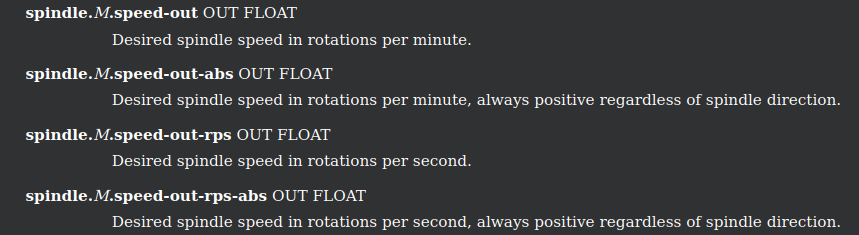

I am trying to get the vfdb_vfd MODBUS driver working for reversing (M4) . It is otherwise working. Linuxcnc expects some forward/reverse pins but (looking at the source code) vfdb_vfd expects a negative speed number to send a reverse command to the VFD.
My current configuration always send positive numbers and asserts the fwd/rev pins instead.
I can find no reference to configuring linuxcnc to send negative speed numbers to the driver for reverse.
if (*(haldata->speed_command) >= 0) {
cmd1_reg |= CMD_FORWARD;
} else {
cmd1_reg |= CMD_REVERSE;

Thank you, I read that severat times, but didn't pick up on the significance. Cut and paste examples... After reading your answer, I found it spelt out in the spindle man page. Sigh.
spindle.N.spindle-rpm float out
Current spindle speed in RPM.+ve = forward, -ve = reverse. Uses the encoder input if available. If not, uses a simulated encoder speed.
