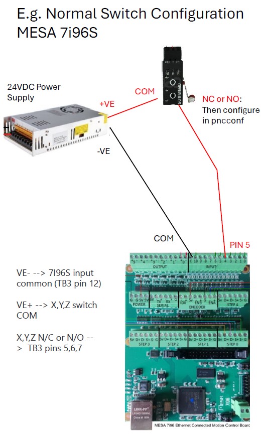

Hi all, I know this has been aske before, however, there does not appear to be a simple visual on it. So thought I would confirm.
I am trying to set up limit switches. I would like to first test config on single switch. I believe that the best way is to wire a 24V power Supply +ve to the switch, then switch to the boards input Common. Then Wire 24V -ve to Input #. (Ref: Image attached.) Is this correct or should it be switch interrupting -ve side pathway?
I believe that once tested as confirmed I can run a single series based set of switches to use for X, Y and Z limit switches. Correct?

I would wire:
VE- --> 7I96S input common (TB3 pin 12)
VE+ --> X,Y,Z switch COM
X,Y,Z N/C or N/O --> TB3 pins 5,6,7

Fantastic. Thanks very much. So for anyone else looking, here is a visual.

Note, I only skipped the first 4 inputs pins so they are available for (up to 2)
MPGs. If you do not have a MPG, starting a pin 1 (input 0) makes more sense.
