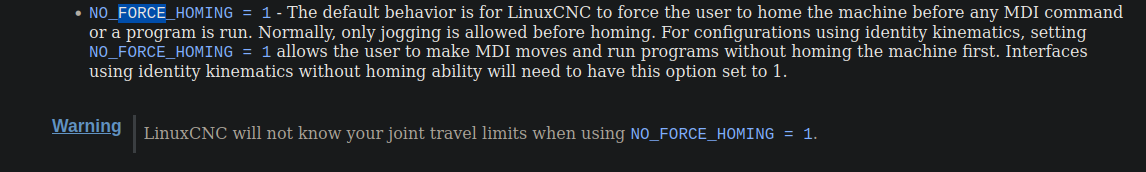

I am working on my CNC from the nice warm space in my office.
I am doing some things that require the software to be restarted.
then i have to home miching to test the changes.
my motors are powered off. but to test i need to go out to the shop, turn on the motors, home the machine, turn off the motors, and test.
I was looking for a way to just tell the machine it is homed form the halscope.
Is there a variable I can set to make that happen?
I do need some exercise but I don't know that I want to get it that way. It is all so cold out.
thanks
thanks

Thanks.
how ever that did not do it.
hoe ever reading through that secting i may have solved a different problem i have from time to time.
so that whas nice.
