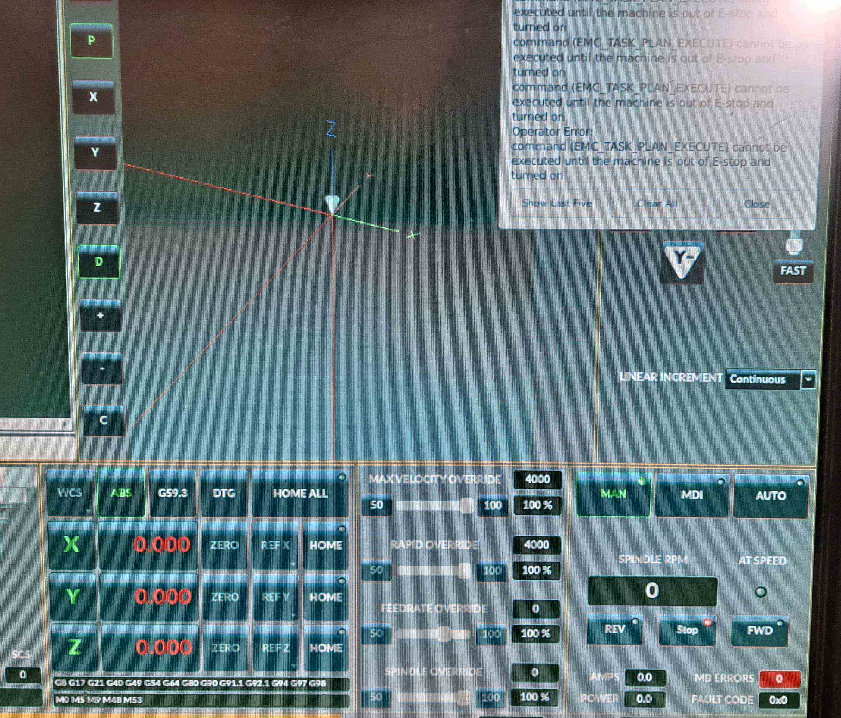

Hello,
i have a issue when i press the Estop button (when i turn on the maschine).
My progress is -->open LCNC, hit Estop to turn on the machine, Hit the machine ON button and after i have to home all axis.
So my issue is when i turn on the machine (all the positions are 0) and when i hit the Estop, the coordinates change always in different position.
I would be thankfull if someone could help me with that.

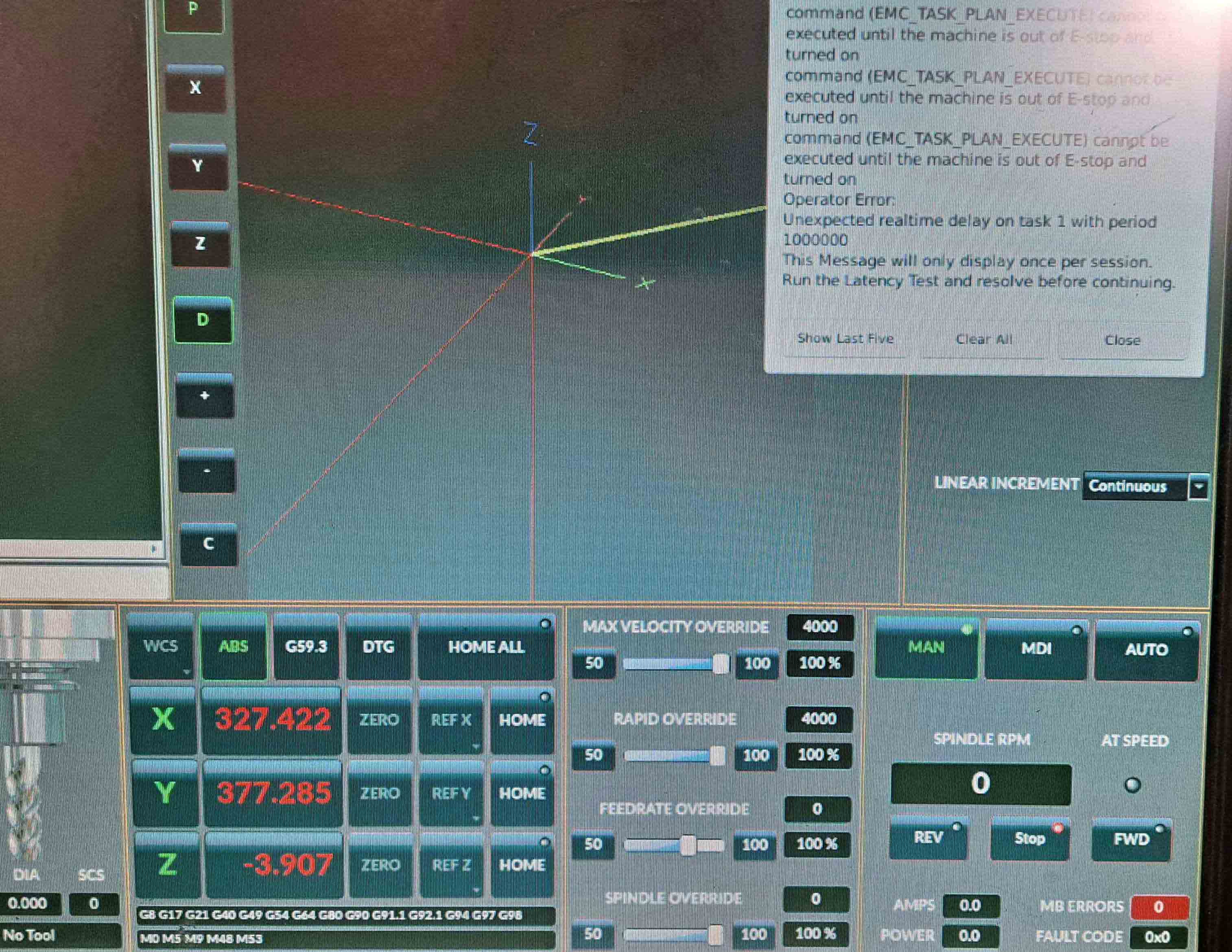

12 Dec 2024 02:05 #316498
by csurimilan
Replied by csurimilan on topic Estop change position coordinate
only in my comuter they are "jumping" to another position (my motors are not moving) and its a larg number like almost 300mm in x and y axis

12 Dec 2024 03:52 - 12 Dec 2024 03:53 #316503
by csurimilan
im using the EC500 motion controller with remora firmware.
im using normal stepper motors nema23 1.8deg with DM556 driver. (without encoder)
my maschine has dual y motors: XYYZ (gantry is woking good)

12 Dec 2024 06:13 #316510
Replied by rodw on topic Estop change position coordinate
it does not matter. if you home your machine, it still has to move to the home switch and homing will zero the DROonly in my comuter they are "jumping" to another position (my motors are not moving) and its a larg number like almost 300mm in x and y axis
