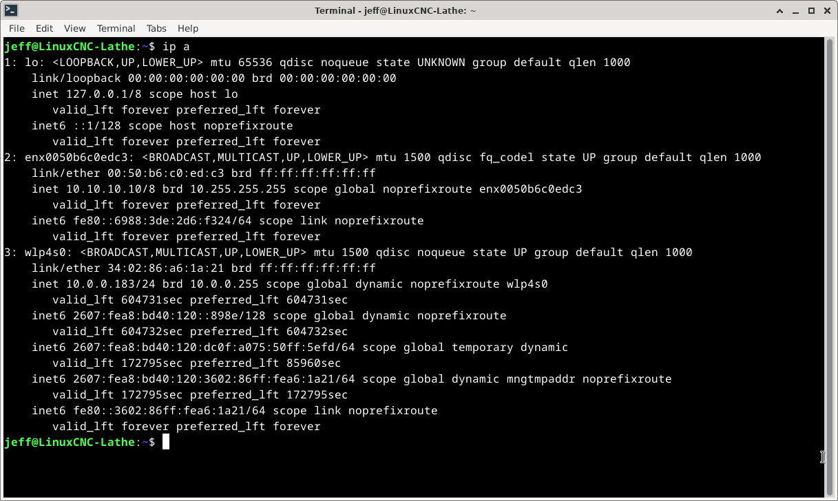

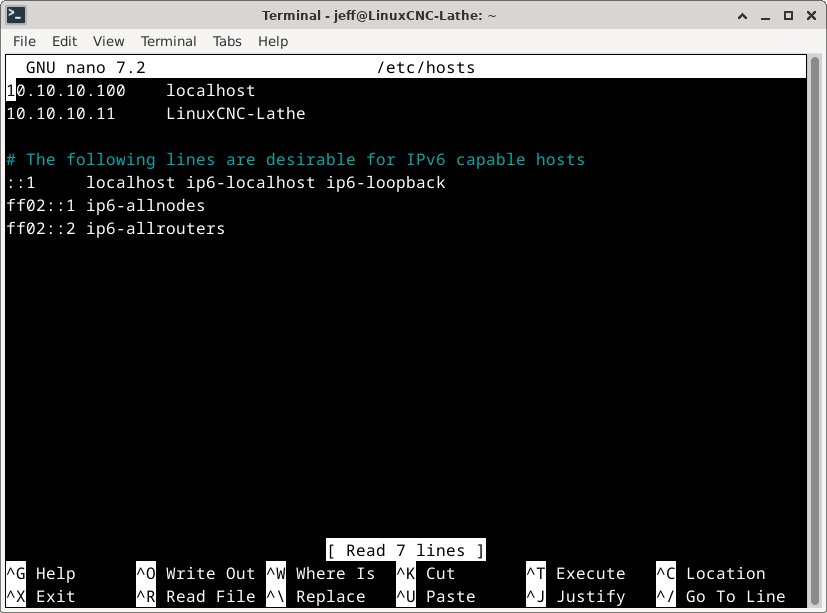

I tried sudo nano /etc/hosts
and then changed 127.0.0.1 to 10.10.10.100 ans saved and rebooted for good measure, however after that and running ip a
I still see host as 127.0.0.1

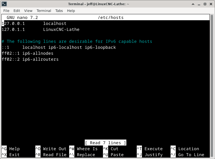

So obviously that's not the correct way to change the host address. BTW I changed local host in /hosts back to the way I found it 127.0.0.1
So how does one go about changing the host address?

You should not change the hosts file, but rather the etc/network/interfaces file

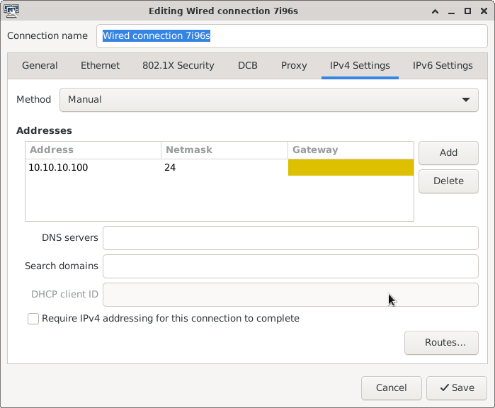

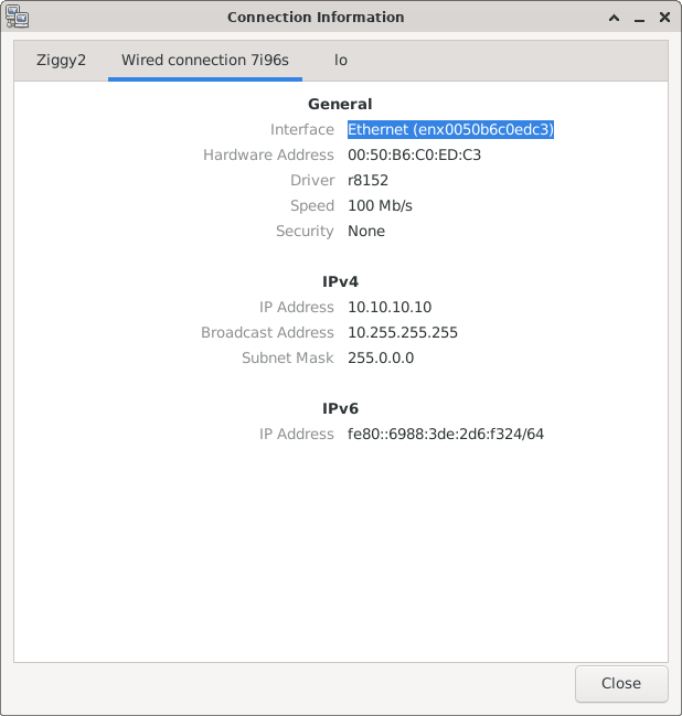

You can set this up with the network manager as you already have
but the address in the network manager should be 10.10.10.100
not 10.10.10.10,
also the netmask should be 255.255.255.0 not 255.0.0.0
not 10.10.10.10,
The following user(s) said Thank You: slowpoke
- slowpoke
- Posts: 224
- Thank you received: 28
01 Jan 2025 22:51 #317812
by slowpoke
However when I enter 255.255.255.0 for the netmask it changes it to 24 when i go back in, not sure if that's a problem?
Replied by slowpoke on topic 7i96s not recognized
okay, finally LinuxCNC starts.You can set this up with the network manager as you already have
not 10.10.10.10,
