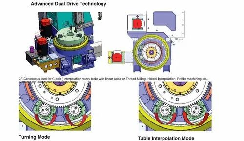

Hi Everyone.
I am new to CNC and This is my first post here. I am trying to build a 4th Axis that is controlled via a ballscrew. In the image attached you can see the motor and bearing for this setup. You can also see the linkages to control the rotation of the axis with the turning of the ballscrew. I wanted to know how I can setup my LinuxCNC to control the axis via the stepper and compensate for the change in angle based on turning the stepper. Thank you for your help in advance, and I apologise if this topic is not covered here. I'm not sure what to search for to find my answer.

Don't do this design! Do it worm gearbox . Just to make the project a success. There should be no play in the spindle.

Hi, thanks for the reply. I don't understand how this would create play. I designed it this way specifically to reduce backlash. I only need a travel of 45 degrees both ways and it needs a lot of torque to the weight of the spindle and motor being offset from center. The linkages are designed to have press-fitted bearings with dowel pins inside so I feel there should be no play. Also, the position of the ball-screw and the length of the linkage were designed to make sure that within the desired travel there are no dead spots. Is there something I am missing which you feel could result in backlash? Thanks again

A simple (simplistic?) way would be to use the lincurve component to compensate for the non-linear rotational distance. Your model also needs to incorporate a pivot at the ballscrew mount since the screw will swing as the B-axis travels.
I would also install a high resolution encoder directly on the B-axis so LCNC can use a PID to adjust for screw mapping and lincurve errors.
But yea, I'd also abandon this idea and use a direct drive motor or a roller cam gear - or even a harmonic with a brake. Even more simple - a big gear with two pinions and two servos. One of the servos is in position mode and the other is programmed in torque mode to oppose the position servo to take up backlash.

Alright, I will list some disadvantages that I see. There are more moving parts and more expensive bearings. The ball screw needs to have a large diameter and be of a high grade. The biggest drawback of this drive system is that it will create not only axial loading on the screw but also radial loading. In other words, the play will depend significantly on the size of the screw.
If you decide to go another route I can give some ideas

Yes I agree that this will put radial load on the ballscrew, I didn't think of that. Ok, I'm open to other ideas please do let me know.

The best option is a worm gear like 4 axes do. The other option is something similar
