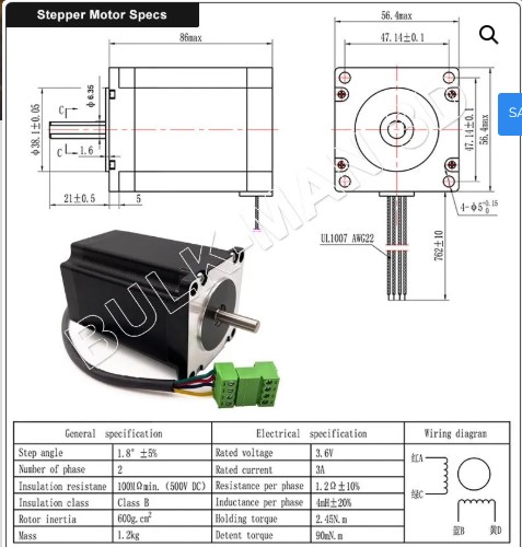

19 Jan 2025 20:25 #319402
by notJamesLee
Replied by notJamesLee on topic Steppers Not Moving / Mapped Wrong
Thanks, I'm sorry im sure this is painful for you guys but it helps me alot.This might be stupid but from the motor to the driver. I took my VMM and ran a continuity tests on the 4 leads on the motor. I found two pairs that were continuous. I assigned one pair to A /- and the other pair to B /- on the high voltage section of the driver. Ill attach the motor and the driver spec sheets (they're not great but they exist).is there a way to tell if the drive is dead? Like some sort or test i can run or check the resistance across some pins? I didn't see any magic smoke and LED indicators are on when the machine has power. I think these are relatively cheap should i just replace them?

19 Jan 2025 21:11 #319409
Set the microstepping switches to 4 or 8, set the current to 2A for now, power on, see if the motors lock.
Additional info:
Those drives do not use the TB6600 chip despite having that plastered all over, they use the TB67S109AFTG, they are much better than TB6600 although a bit less current, do more microsteps, have some protections so can handle some incidents while 6600 can not.
All in all, much better chips.
The only issue i encountered with them is the DIP switches tend to cause issues due to vibrations, 4 out of 20 had this issue, can be easily fixed by soldering or cutting switch pins

20 Jan 2025 16:28 #319469
by notJamesLee
Okay friends update.
Since all my drivers are all wired into the machine i built a little test rig with a spare stepper and micro controller to ensure all drivers weren't cooked and dip switches are correctly set.
I was able to verify that all the impostor tb6600 drives work once i changed their dip switches. The steps/rev in my code and what i'd expect from the dip switches being set doesn't line up but they all perform like i'd expect so I put them back into the machine.
However i wasn't able to get my C axis driver to spin the test motor. I am writing this off as its a closed loop motor driver trying to move an open loop stepper ( not sure this is the correct perspective) but i will solve it later.
X and Z now jog!!! I am waiting on some hardware to swap out because there's alot of rattling so i plan on replacing the mounting bolts and shaft collars.
I cant seem to find any of the limit switches in Halshow so i am not able to get Y moving. I set the up as min limit +home and have min-home x/y/z in the scope to be shown but i do not get any state change when i press the switch down. I have them currently wired 24V+ - > NC - > C - > mesa input. Any ideas there? I've seen people wire 24V to the common input on the mesa?
