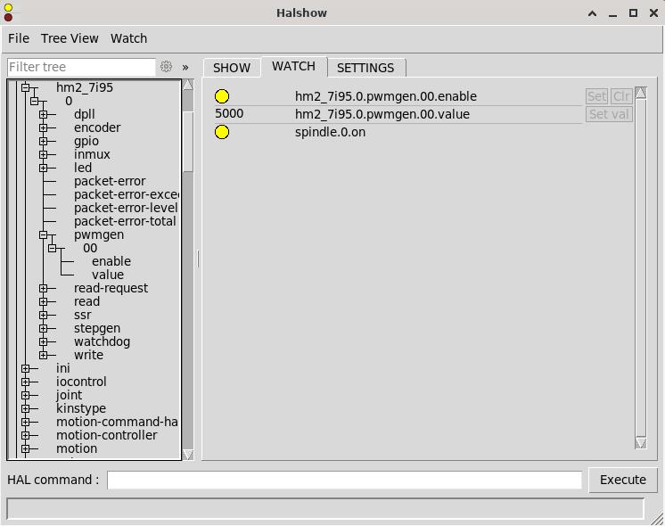

I came this far, but getting no readings on 7i78 SPINDLE OUT terminal (SPINDLE- is GND and SPINDLE+ is +10V, both from VFD)
setp hm2_7i95.0.pwmgen.00.output-type 1
setp hm2_7i95.0.pwmgen.pwm_frequency 15000
setp hm2_7i95.0.pwmgen.00.scale 16000
net spindle-on <= spindle.0.on
net spindle-on => hm2_7i95.0.pwmgen.00.enable
net spindle-ramped => hm2_7i95.0.pwmgen.00.value

08 Feb 2025 11:01 - 08 Feb 2025 11:02 #320985 by tommy
Replied by tommy on topic 7i95T + 7i78 spindle configuration
Thank you for those lines, I'm now receiving signals!
Could you suggest the appropriate numbers for type, frequency, and scale?
I attempted the following settings, but I’m getting a +10V output at the spindle, even at M3 S9000. This should ideally be half of that value.
setp hm2_7i95.0.pwmgen.00.output-type 2
setp hm2_7i95.0.pwmgen.pwm_frequency 2000
setp hm2_7i95.0.pwmgen.00.scale 0
Last edit: 08 Feb 2025 11:02 by tommy.
08 Feb 2025 15:01 #320996 by tommy
Found the problem, as for my VFD pwmgen output has to be inverted (setp hm2_7i95.0.pwmgen.00.out0.invert_output true), after that scale started to work in right direction.
