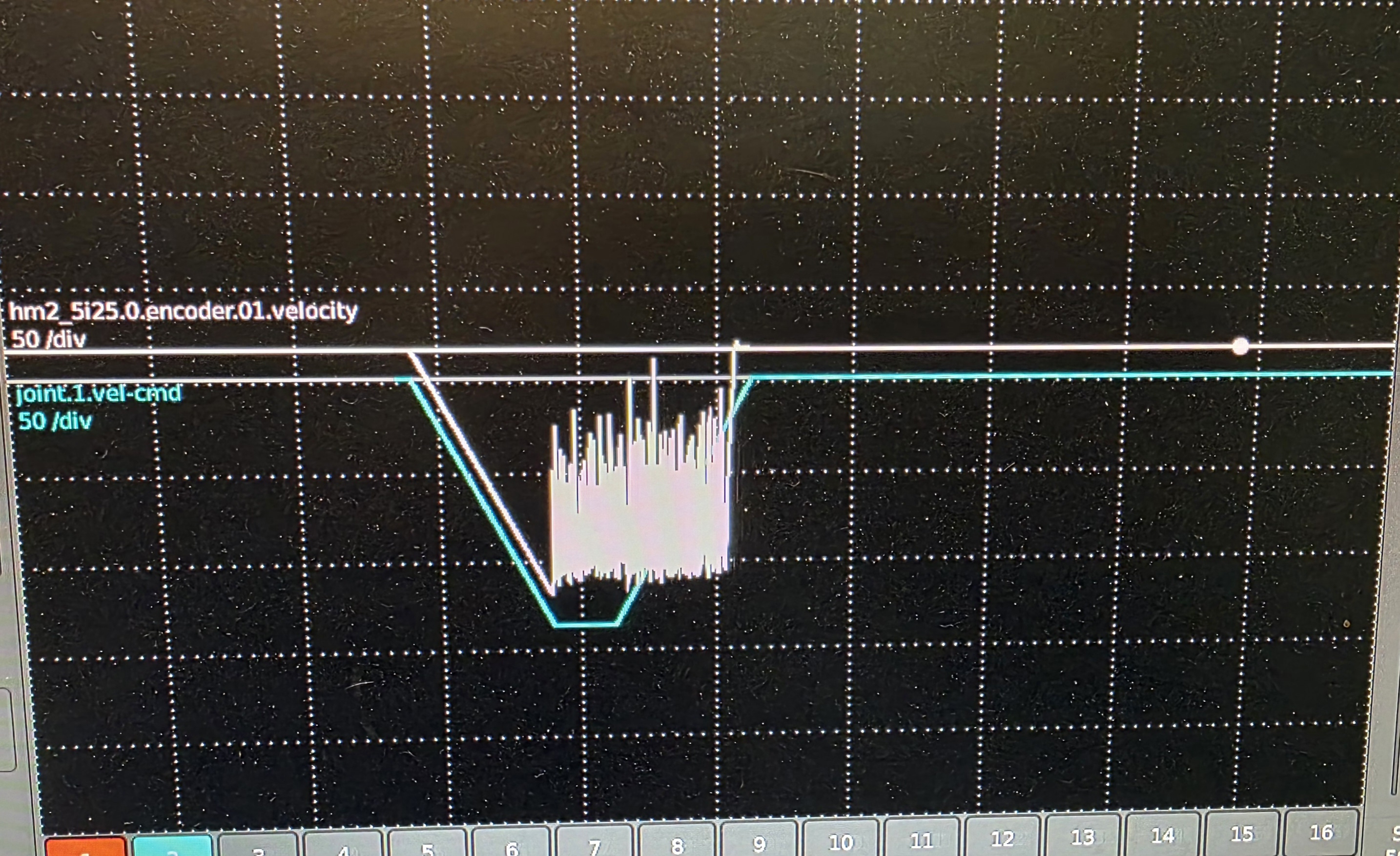

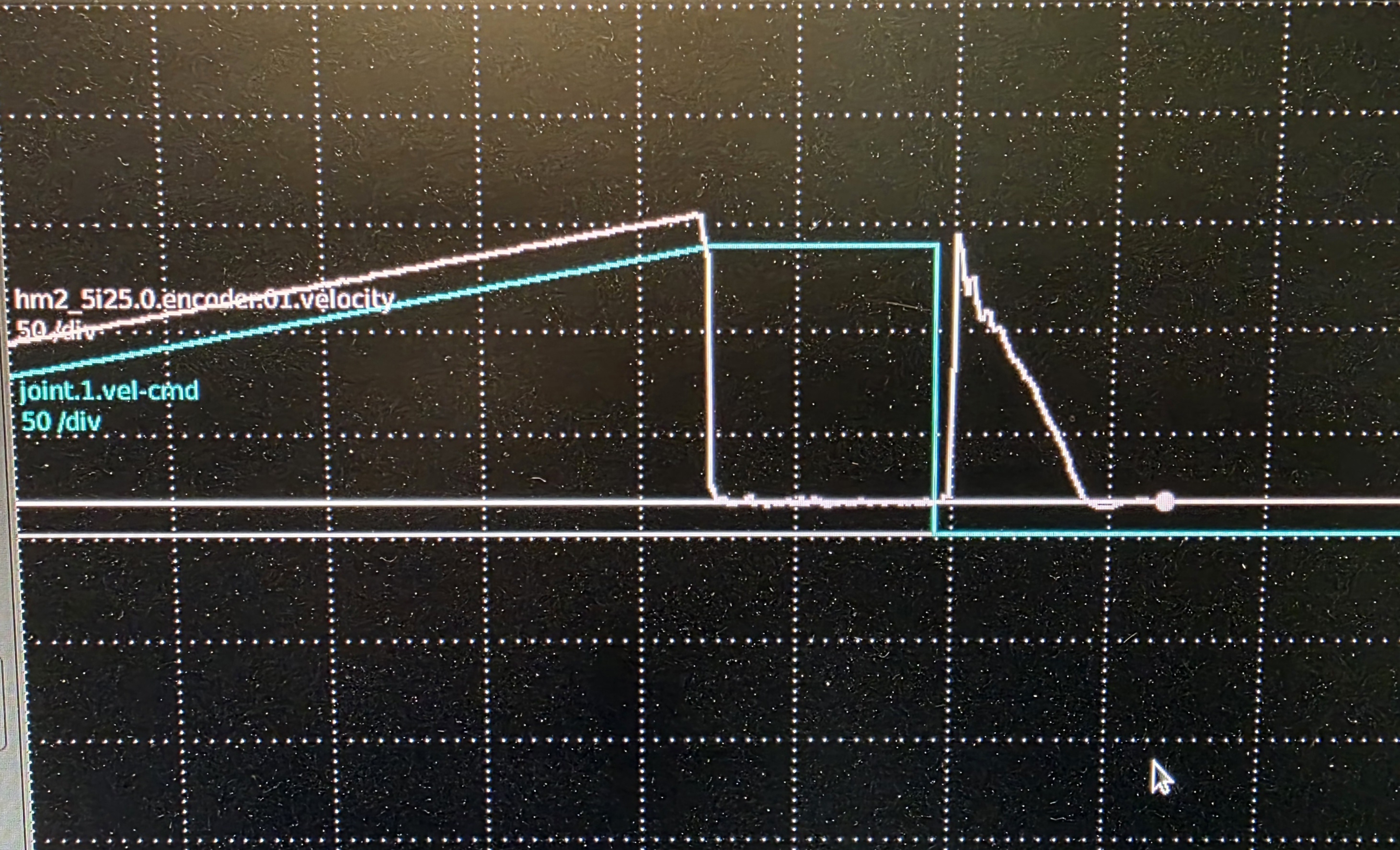

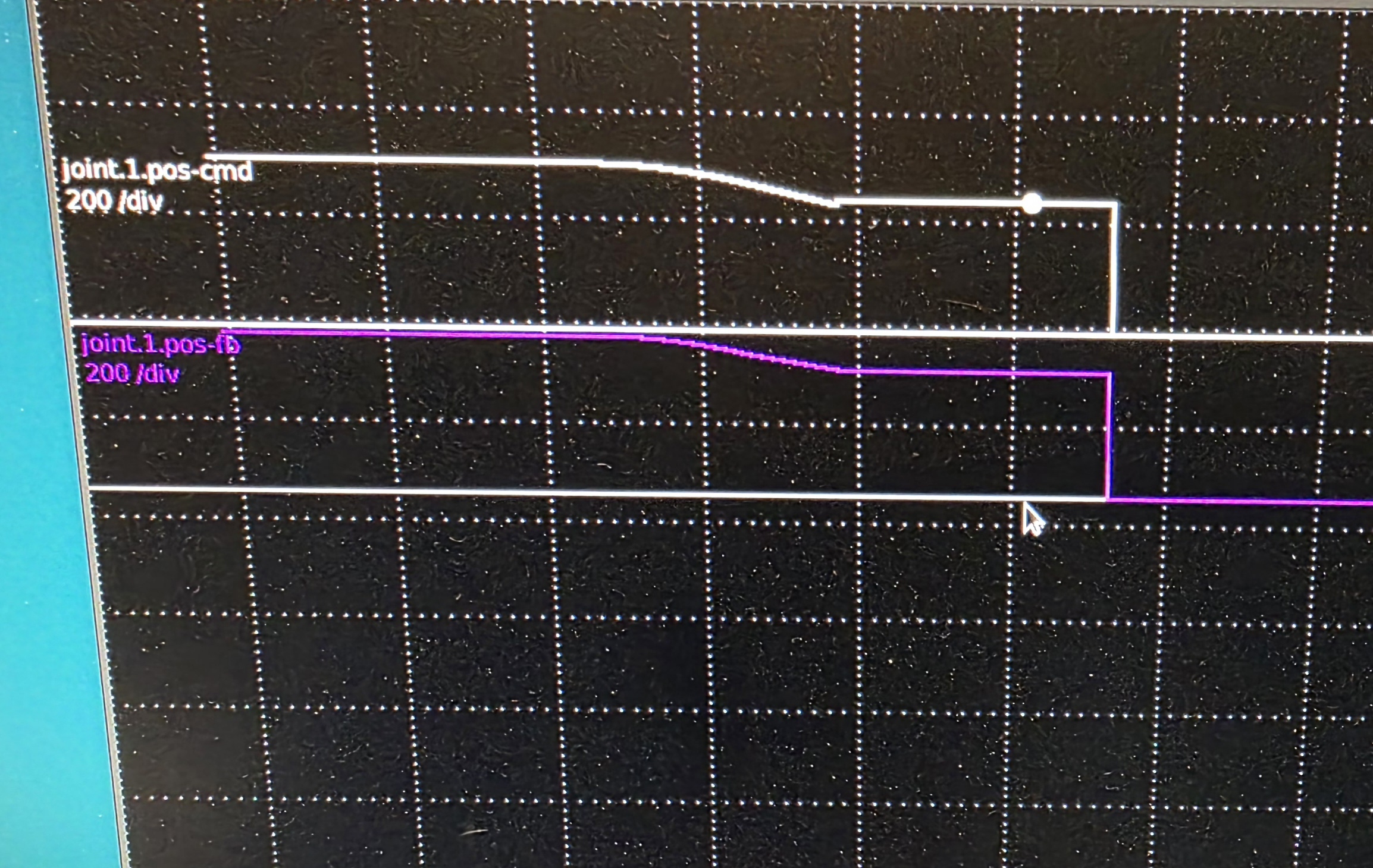

Replied by PCW on topic Servo Oscillation Issue at ±3.3V 5i25 + 7i77, Analog Control
Note that
setp hm2_5i25.0.encoder.00.filter 0
only changes the X axis.
Plotting the velocity, commanded and feedback position
should give the information needed to diagnose the issue.

15 Feb 2025 18:42 #321654
by Traken
Replied by Traken on topic Servo Oscillation Issue at ±6.6V 5i25 + 7i77, Analog Control
I'm posting screenshots from halscope. I think the encoder had some noise.
