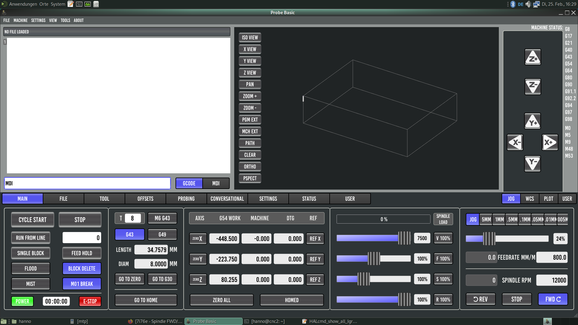

Hello together,
another question and problem with my LCNC config.
After solving installation, homing, network, latency problems with your help, I could make the next step and check my spindle output function.
I'm using a chinese 2,2kW standard spindle with a Hitachi WJ200 VFD, parameters set with Hitachi proDrive, the FWD/Stop control is working correctly, but I cannot measure any volts at the Spindle Output of my 7i76e TB4. The electronic pot gets 10V from an external voltage source, these 10V are measureable at TB4, Pin 3.
Im using Probe Basiv V.5 under Debian 12 and LCNC 2.9.3. on a Lenovo Think Centre M92p Tiny, 8 GB i5 2900 GHz.
I set the output with MDI S6000 and can see, that spindle-out goes to 100 (rps), Spindle-enable goes on, but I can not see any voltage at Pin 3.
Do you have any idea what is going wrong here?

If you run LinuxCNC, enable the spindle and set the spindle speed say 1/2 way up, then:
halcmd show all | grep spin
and post the results here, that would help debugging this.

PCW, thanks for your eyes on it. Here the lines:
