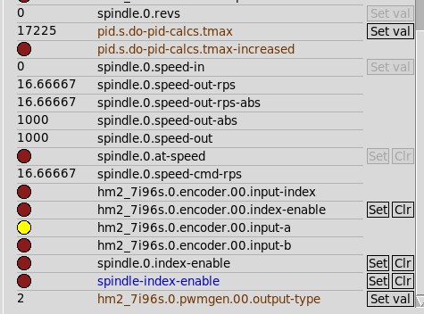

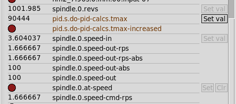

- vibram
- Posts: 84
24 Mar 2025 19:34 - 24 Mar 2025 19:50 #324812
by vibram
Replied by vibram on topic Spindle keep accelerating
Last edit: 24 Mar 2025 19:50 by vibram.
