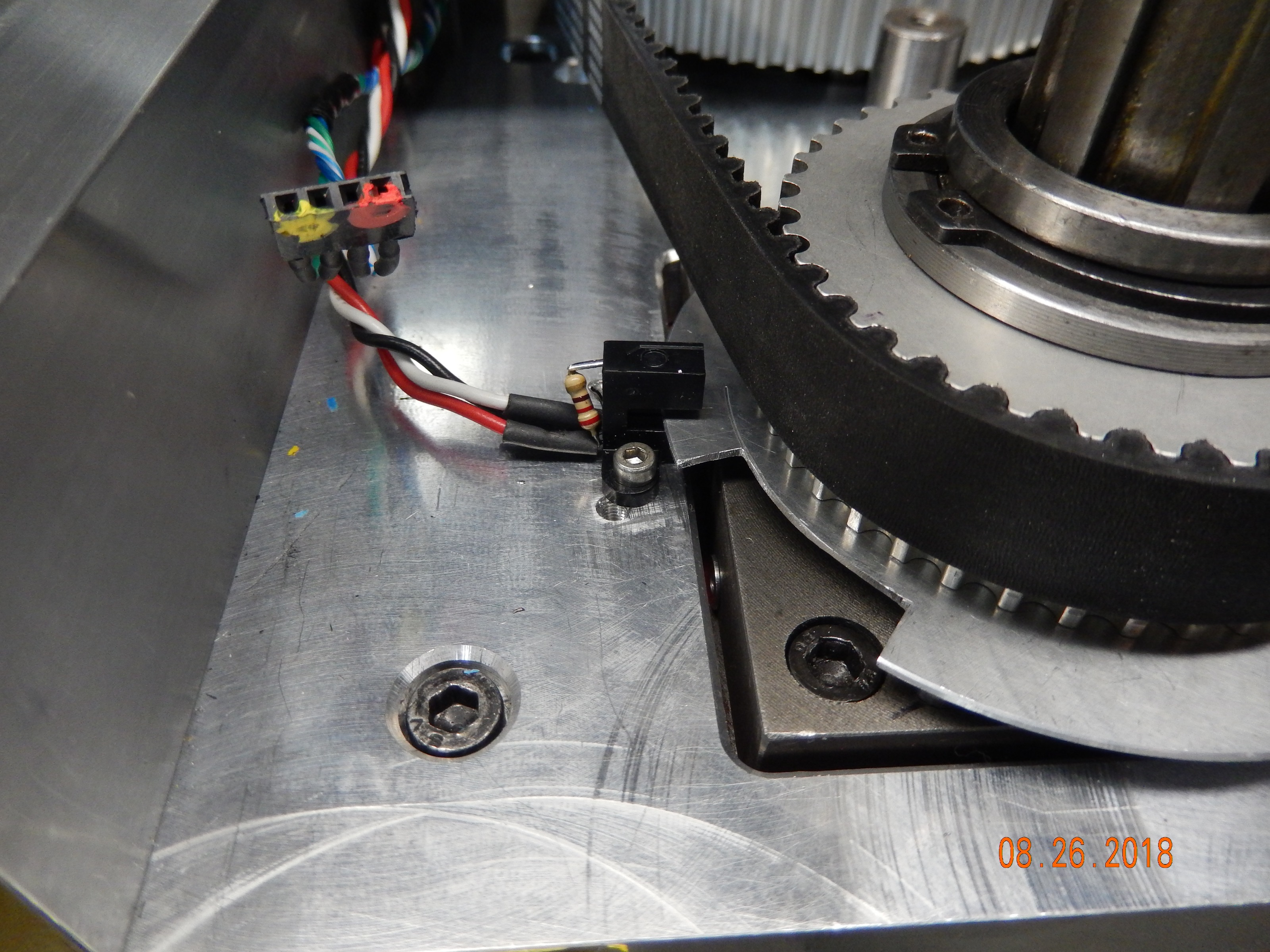

14 Apr 2025 22:01 #326321
by JohnnyCNC
Replied by JohnnyCNC on topic spindle with encoder
- vre

15 Apr 2025 01:14 #326329
by JohnnyCNC
My top spindle speed is 5400 RPM and that plate is .032" aluminum. If it does cause vibrations, they are too small for me to notice.

15 Apr 2025 22:14 #326413
by JohnnyCNC
Hold on a second. I lied. Not intentionally. My spindle motor is a DYN4 servo motor geared 1:1.8 and it has a simulated encoder signal generated by the servo driver. That is the signal I am using for the coordination for rigid tapping. The sensor on the slotted plate it just for measuring RPM.
It's been a few years since I set this up and when you mentioned more slots I thought "I knew that, why didn't I do that?" Then I looked deeper and remembered how it really works.
To actually do this with a slotted plate and sensors you would want more slots and two sensors. Read up on how quadrature encoders work.
As long as you know the ratio between the spindle and encoder you can make almost any arrangement work.
