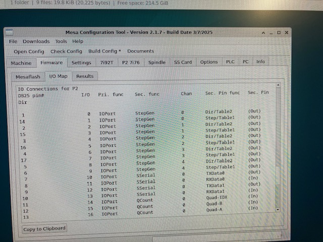

Just to recap, as its been a week or two, I have one 7i92t and one 7i76u, and need currently need 4 axis XYYZ, and 4 limit/home switch inputs.
Thank you , I did not know that P2 was the first connector by convention. I have since connected the 7i76u straight to the P2 connector of the 7i92t (the genders do work fine). The config from before could not find the inputs (that it previously found) and it wouldn't run. I figured the names are probably different, I fiddled about but didn't get it to work.
I tried again using pncconf this time.
The firmware I am using is called 7i92t_7i76x2d.bin, and I am only entering info into the P2 tab.
I see in the manual of 7i76u (page5) that its P1 has the following
db25pin to gpio to direction
10 IO13 IN
11 IO14 IN
12 IO15 IN
13 IO16 IN
This maps to the manual of 7i92t connectors (page5) for P2 as
10 IO13
11 IO14
12 IO15
13 IO16
So seems like both go together fine in both db25 pins, and in IO names.

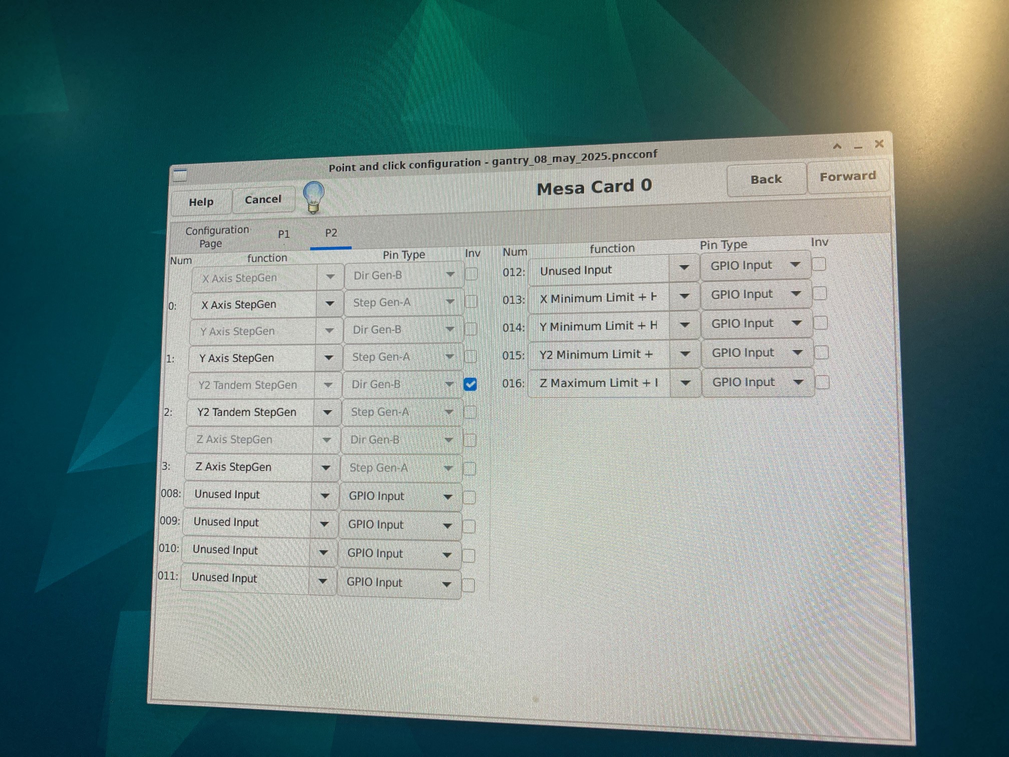

In the HAL file these pins are ([HMOT] CARD0=hm2_7i92.0)
# external input signals
# --- MIN-HOME-X ---
net min-home-x <= [HMOT](CARD0).gpio.013.in
# --- MIN-HOME-Y ---
net min-home-y <= [HMOT](CARD0).gpio.014.in
# --- MIN-HOME-Y2 ---
net min-home-y2 <= [HMOT](CARD0).gpio.015.in
# --- MAX-HOME-Z ---
net max-home-z <= [HMOT](CARD0).gpio.016.in

You do not use the GPIO pins on P1 or P2, these are for communication with the 7I76
When using pncconf you would setup the I/O on the 7i76 TB5 and TB6 tabs and the hal file connections
would look like this:
net min-home-x <= [HMOT](CARD0).7i76.0.0.input-13
net min-home-y <= [HMOT](CARD0).7i76.0.0.input-14
# --- MIN-HOME-Z ---
net min-home-z <= [HMOT](CARD0).7i76.0.0.input-15

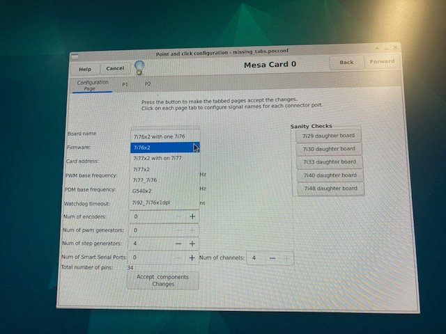

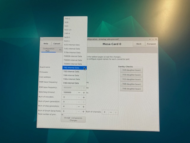

"When using pncconf you would setup the I/O on the 7i76 TB5 and TB6 tabs ..."
Ah, we must be looking at different software outcomes, because I have no TB5 and TB6 tabs
Maybe the menus are dynamically generated by the selected choices?
Attached are images of the two drop down choices that I have available
Which options should I be selecting (for a 7i92t with a 7i76u directly attached)?
for board: 7i92-internal-data (is the one I was using (does it refer to the 7i92t? or the 7i76u? )
for firmware: I have tried the first two, and the last one
None of them generated any TB5 and TB6 tabs.

- Posts: 18105
- Thank you received: 5328
13 May 2025 23:19 - 13 May 2025 23:35 #328428
Replied by PCW on topic None of the axis are moving - using mesa 7i92t with 7i76u
Last edit: 13 May 2025 23:35 by PCW.

Hi PCW

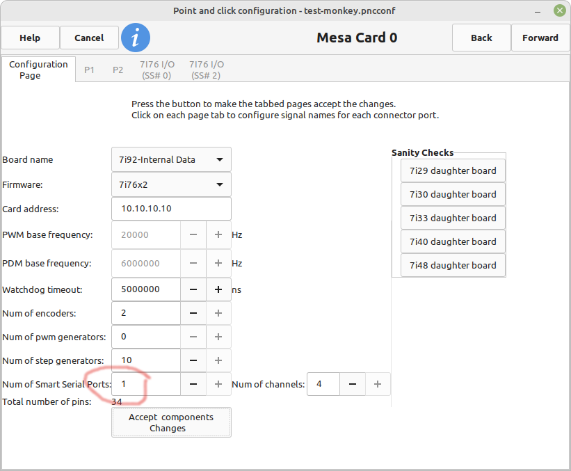

Yes, I did set it to zero
I did not know that Smart Serial Ports were needed to make anything io cards work.
I thought Smart Serial IO was to link via serial connectivity to some kind of remote daughter board.
I shall search on the forum to find out more about it.
Many thanks for your help
Yes, the field I/O section of a 7I76 is a Sserial device (basically a 7I84 but local)

I added one Smart Serial (instead of previously none) , which did indeed restore the missing 7i76u TB5 and TB6 tabs.
I tried configuring it with pncconf (hal, ini attached) and with mesact2 (hal, ini and .io attached)

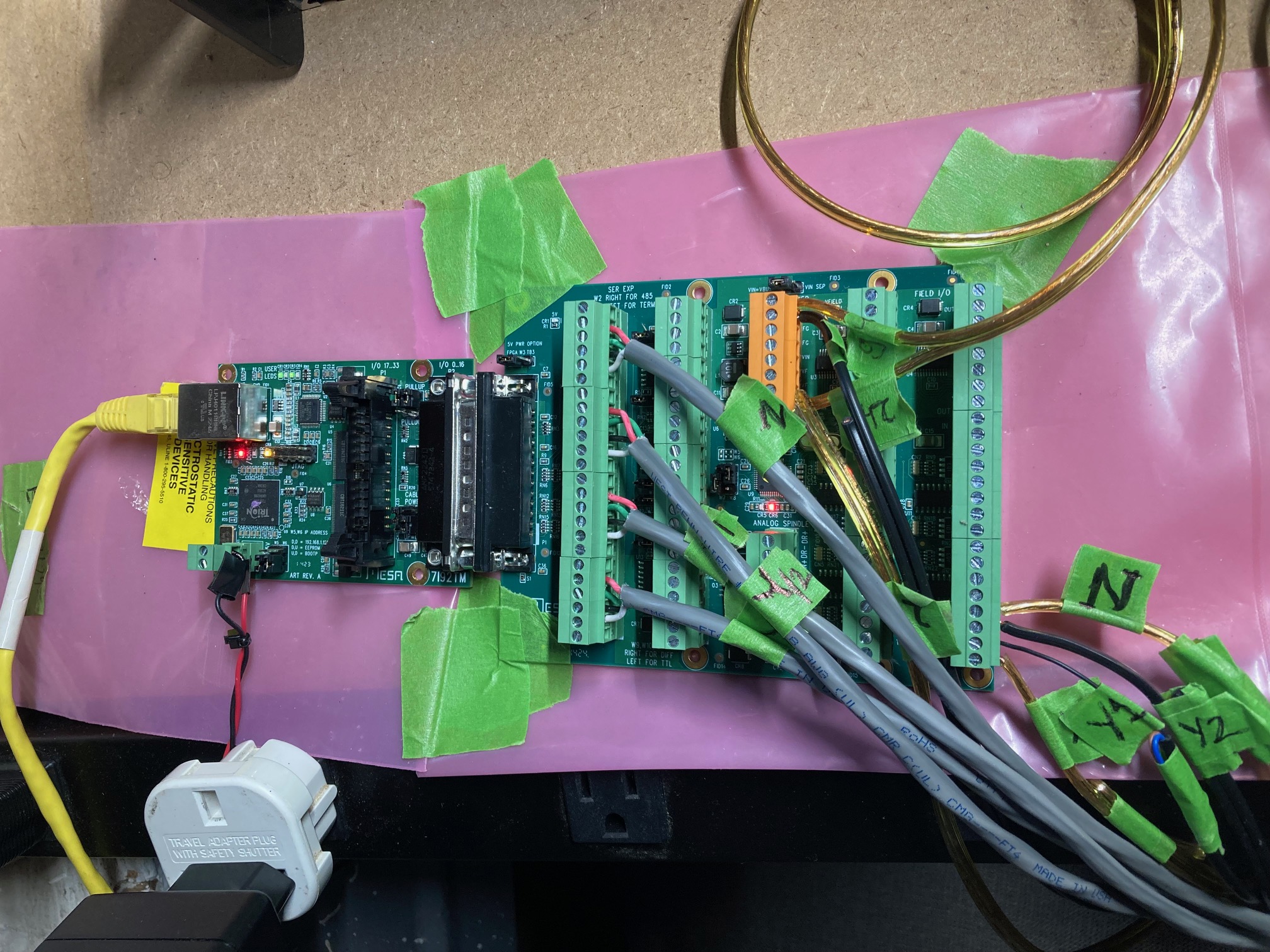

two of the inputs (x and z) are normally closed switches providing 24 volts , and two (y and y1) are proximity sensors providing 24 volts .
Using a multimeter all four inputs measure 24v field io (when measured between 7i76 Field IO Power FG, and the relevant TB pin)
I added a photo so that you can see where the input wiring is going.
On power up the 7i92t has PWR led on yellow, CR1 led on green , the 7i76u has CR3 led on yellow, and the watchdog CR6 led on red (it does not get reset, because the config fails to load)
If Linuxcnc doesn't like the config and aborts , then there is nothing to see using halshow.
its got to be something obvious , just it's not obvious to me
Looks like no 5V to the 7I76U
(7I92T W4 needs to be "up")
