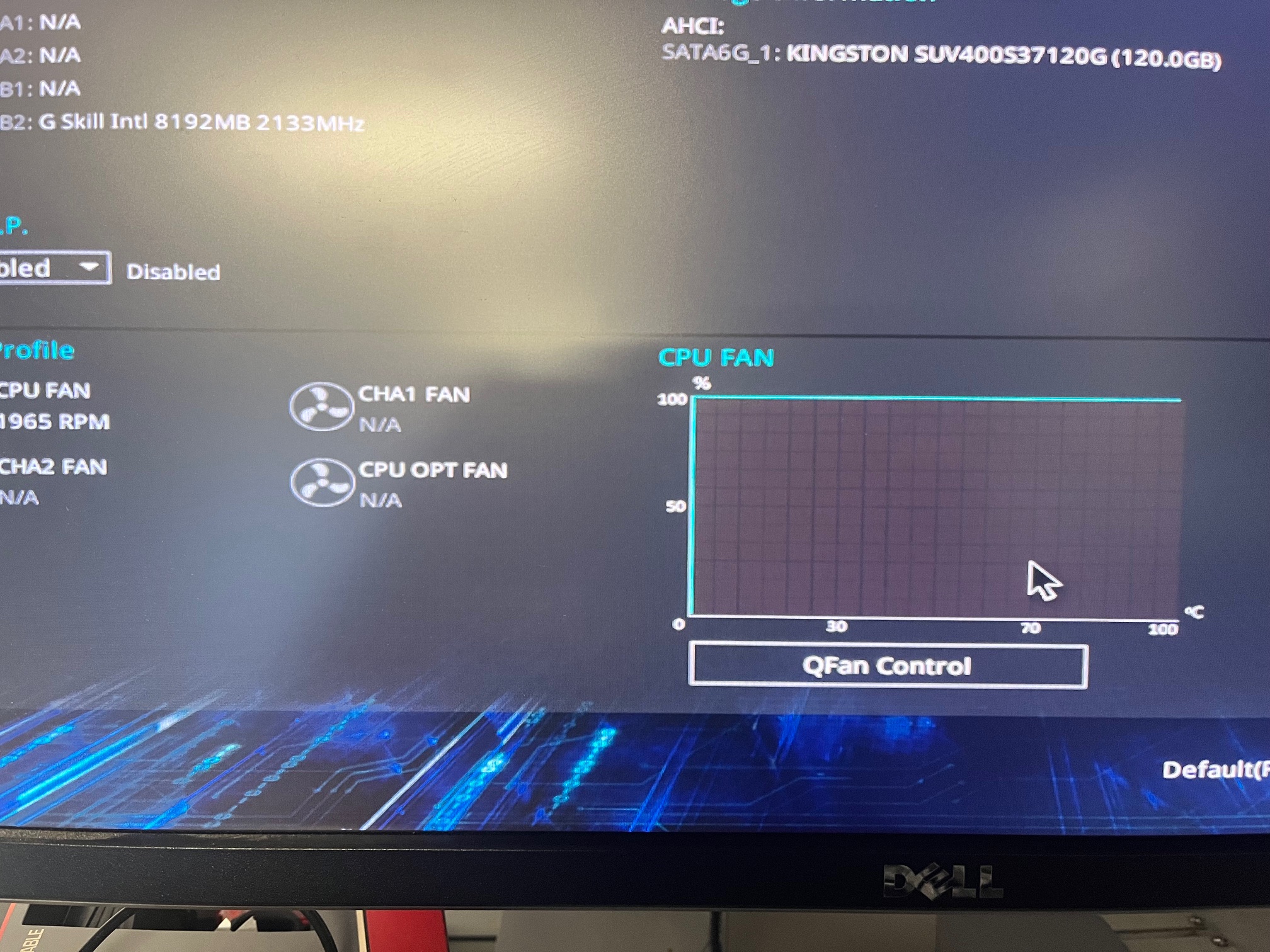

Hi all,
It’s been (far) too long since I last had time for CNC projects. Fortunately, things have settled down a bit lately, and I’ve been able to pick up the hobby again. However, getting my machine up and running has proven to be more of a challenge than expected.
My old Intel setup (with a 4790K) had both a faulty motherboard and RAM, so I replaced it with an ASUS AM4 board and a Ryzen 5600 CPU. Since then, I've been struggling with what seems to be very high latency.
To make matters worse, I used to run LinuxCNC 2.4, but I’ve now reinstalled everything using the latest stock ISO (2.9 with the PREEMPT-RT kernel). Unfortunately, this means my old configuration is no longer compatible.
I’ve uploaded my current settings, including the BIOS changes I’ve made in an attempt to reduce latency. At this point, my first goal is simply to get the axes moving at a reasonable rate. Right now, I can’t get it to move faster than about 1 mm/sec (rough estimate) before I run into either a joint 0 following error or an error about the base thread timing.
If anyone has tips or suggestions based on my setup or config files, I’d really appreciate the help. The machine used to run at a speed much faster than the tool could handle, so I know it's capable — I just need to get the configuration right again.
I’m aware that my .hal and .ini files likely need significant changes. I've done my best to port over the old configuration, but clearly, it’s not quite there yet.
Thanks in advance for any insights or advice!
The images are from 1 to 12, replace the number in the URL. I cant post that many links

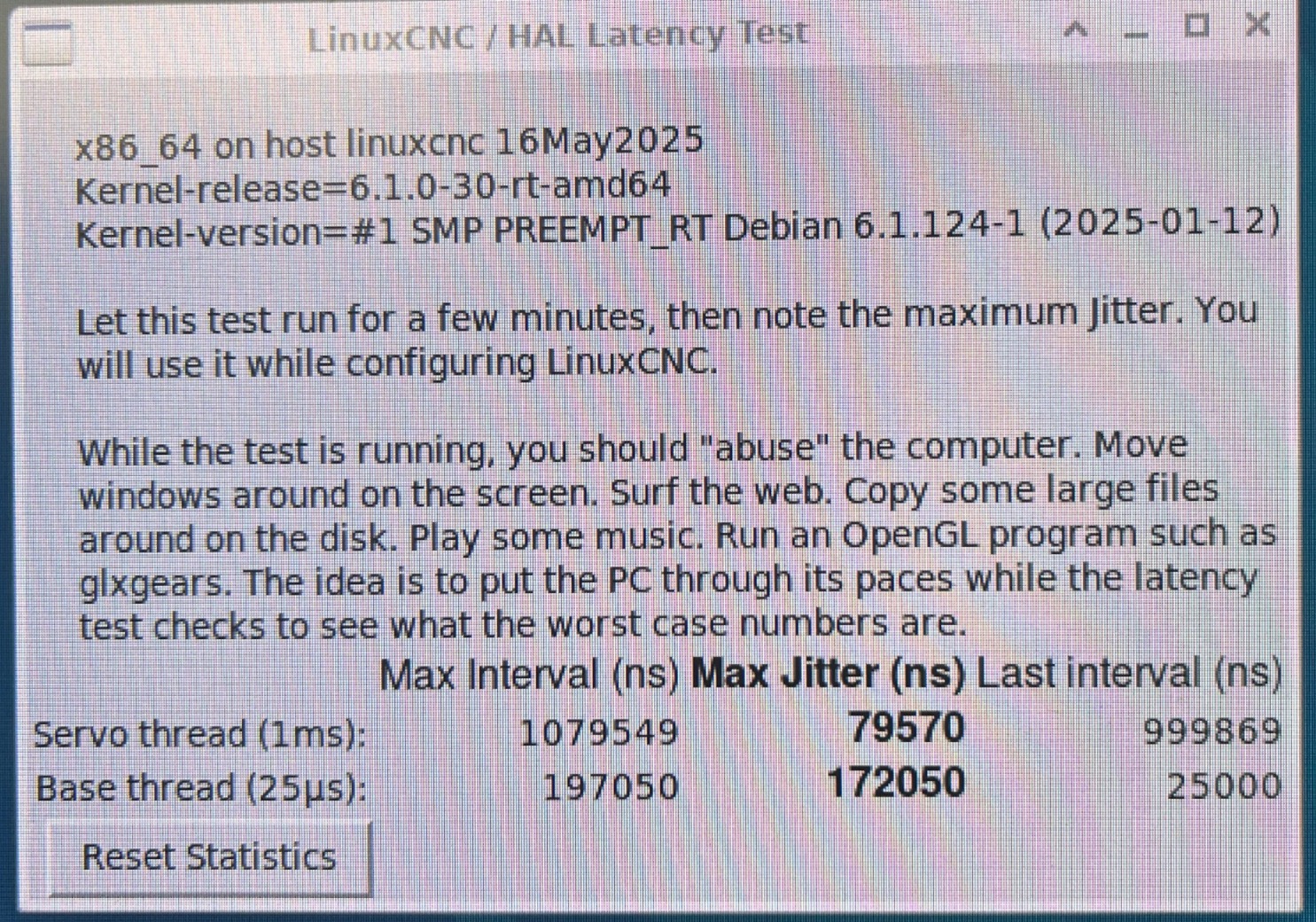

There's quite a few threads regarding latency, there's a quite a long one from just this week.
Your max speed will be a function of step per rev and your base thread.
You could try isolating the last 2 cores via the kernel command line.

Hi, thanks for your response!
Do you happen to have a link to that specific thread? I might have missed it.
I've read a lot of posts and tried many things in both the BIOS and on the CNC machine over the past month, but nothing seems to help so far. I haven’t tried any bootloader or CLI-based options yet, so that might be worth exploring next.
That's why i have the feeling i am missing something obvious because this is my first AMD CPU machine. In the past i had 2 intel systems before and never had this extreme latency. Also i always used my AMD Firepro graphics card. So the GPU did not change over time.
::EDIT:: Alright isolating cores seems to be a step in the correct direction. I changed my GRUB conf to:
GRUB_CMDLINE_LINUX_DEFAULT="quiet isolcpus=2,3 nohz_full=2,3 rcu_nocbs=2,3 idle=poll processor.max_cstate=0 amd_pstate=disable"
to free up my core 2 and 3. If i do a latency tests i now have a servo thread < 25 000 and a base thread < 120 000. So that is better. I think i it still not ideal to have such a high basethread... still the:
- joint 0 following error
- unexpected real-time delay
errors even if i start linuxcnc on the isolated cores via #!/bin/bash
taskset -c 2,3 linuxcnc /home/npostma/linuxcnc/configs/CNC/CNC.ini
Validated with `ps -eLo pid,psr,comm | grep -i linuxcnc` that it did run on the isolated cores. I also see in HTOP that the cores are isolated. No processes go to them.
Thanks again!

Keep playing with different combinations of cores isolated using isolcpus till you find what gives you the best result. Your Ryzen has 6 of them to choose from, I'd test different combinations of 1, 2, and 3 cores isolated, like 1,3,5 or 3,4,5 or 0,1,2, or 4,5, or 0,1...

Things i disabled next to the obvious, like settings for fixed clock speeds (fclock 1066, bclock 1000) disabling power management and disabling hardware that is not being used (BT, Wireless, serial, audio, fancontrol (disabled fixed on 100%)):
BIOS Settings (set to Disabled):
SMT / Hyperthreading
→ Disables logical cores to reduce cache sharing and latency spikes
C1E, C6, and other C-States
→ Prevents the CPU from entering sleep states, ensuring consistent timing
Streaming Stores Control
→ Avoids aggressive memory write optimizations that can disrupt real-time behavior
DRAM Scrub Time
→ Turns off background memory error checking to avoid unexpected memory bus usage
GMI Encryption Control
→ Disables inter-chiplet encryption on Infinity Fabric to reduce overhead and latency
XGMI TXEQ Mode
→ Prevents signal equalization tuning that could introduce instability or variability
DRAM Map Intervention
→ Disables memory remapping logic that can introduce unpredictable latency
DF Sync Flood Propagation
→ Prevents error broadcasts across chiplets, reducing the chance of system-wide stalls
