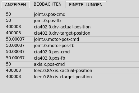

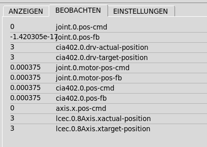

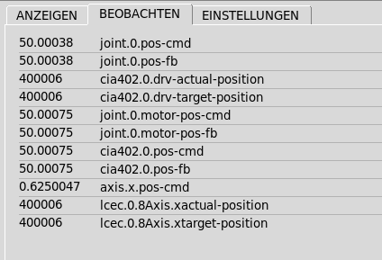

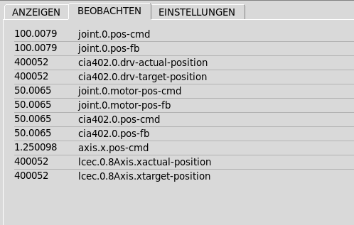

19 May 2025 11:07 - 19 May 2025 12:02 #328733 by low-blip
I just tried that, not sure if I found something useful but something strange did come up.
The pins I looked at were:
joint.0.pos-cmd
joint.0.pos-fb
cia402.0.drv-actual-position
cia402.0.drv-target-position
joint.0.motor-pos-cmd
joint.0.motor-pos-fb
cia402.0.pos-cmd
cia402.0.pos-fb
axis.x.pos-cmd
cec.0.8Axis.xactual-position
lcec.0.8Axis.xtarget-position
all seem like they're what they should be except axis.x.pos-cmd, after I sent G0 X50 in MDI mode, it was 50, everything was fine, then I switched to manual control mode, it changed to 0.625. That is also when I get the motor position error.
I took some screenshots at startup, after homing, after sending a G0X50 command and after I got the error. I don't have anywhere to host the images though, so I put them in the attachment in case that helps.
Last edit: 19 May 2025 12:02 by low-blip.
19 May 2025 12:31 #328739 by Hakan
Suddenly a big shift in axis.x.pos-cmd while joint.0.pos.cmd stays? When you shift between MDI and Manual.
The translation between joints and axis is done in the kinematics module but there are more things involved I don't know so much about.
I see you have a userkins module, that one becomes suspicious of course.
You can follow the signals, ms by ms, using the halscope utility.
Maybe interesting to do that when you shift between MDI and manual.
Judging from the halshow output you EtherCAT drives behave as they should. The problem isn't there.
