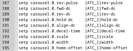

hi!
i wonder why this not work. is it not possible or is there a workarround?
i add the ATC (carousel.comp) to the ini
in my hal i link it

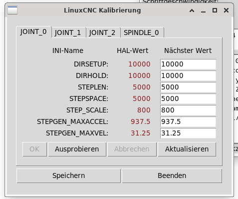

but on the calibrationscreen i got no new tab
is this not possible?! thanks

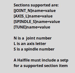

[ATC_1] is not a recognized section name for the calibration tool.
It only works with '[TUNE]', '[JOINT_n]', '[AXIS_l]' or '[SPINDLE_n]' sections.
28 Jul 2025 19:55 #332496 by hitchhiker
Replied by hitchhiker on topic Adding Section to INI and Calibrationscreen?
perfect!!! it works ! Thanks!
