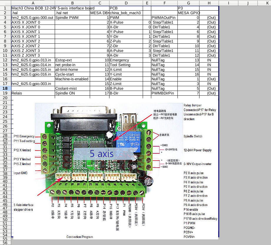

Hi there
A question about my configuration:
1. I have a HF milling spindle which needs only to turns clockwise. The PWM canal (Out0) works fine. My config for "pwm/dir" (Out1) is set to a relay output (P17/"GPIO7"). The relay should be on when CW is commanded but here it is on when CCW is commanded. How config it so that the relay switch on when CW is commanded?
Mesa 6i25 with homemade pin file
China BOB Mach3
Linuxcnc 2.8.4-1gb7824717b
# Erstellt von PNCconf am Mon May  1 19:24:03 2023

setp hm2_6i25.0.dpll.01.timer-us -50
setp hm2_6i25.0.stepgen.timer-number 1
# extern signal input
# --- MACHINE-IS-ENABLED ---
#gpio.001 MESA DB25 PIN PIN 14
setp hm2_6i25.0.gpio.001.is_output true
net machine-is-enabled  =>     hm2_6i25.0.gpio.001.out
# --- COOLANT-MIST ---
#gpio.005 MESA DB25 PIN PIN 16
setp hm2_6i25.0.gpio.005.is_output true
#net coolant-mist  =>     hm2_6i25.0.gpio.005.out
# externe signal output
# --- ESTOP-EXT ---
#gpio.013 MESA DB25 PIN PIN 10
# .in_not for NC / .in for NO Limit Switch
net estop-ext     <=  hm2_6i25.0.gpio.013.in_not
