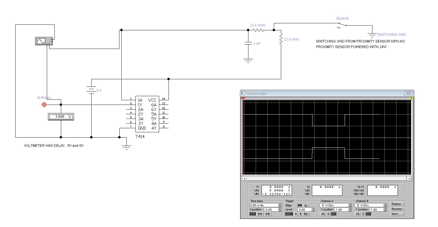

original on this machine the signal cable goes to a 22k ohm resistor which is connected to ground. Then it goes to another 22k resistor in series.. which haves a ceramic cap 1nf to gnd. and then to a 74c14 schmitttrigger.. from there it goes to the mcu.

Here i am again.. this shows us the original circuit of the original controller . the proximity sensor switching gnd. Its a npn normaly open proximity sensor without shielded cables.
Sensor is powered with 24v.
my now setup is:
the output cable from the sensor goes direct to my mesa 7i92t. i see the gpio toggles if i bring the sensor to some metal. it works. the mesa 7i92t is jumpered to pullup.
if i use this circuit i must set the jumper to pulldown. correct?
thanks for your help

On the bench it works.
Important is to know that the signal is inverted.
Option 1 use a second schmittriger to re invert. As example.. from 1Y to 2A and from 2Y to motion card.
Option 2 change signal in hal from in to in_not.

Either way will work, there is no technical advantage of using 2 external
inverters.
Pullups/pulldowns on the 7I92T don't really matter for this specific signal
since they are overdriven by the Schmitt trigger
(the pullup/pulldown mode may matter for other signals)
inverters.

It works.
I use a second channel to re invert the signal.
Now no noise on the signal.
