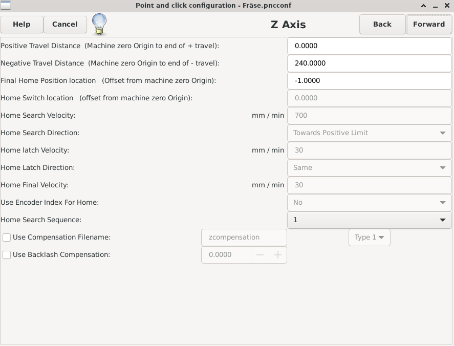

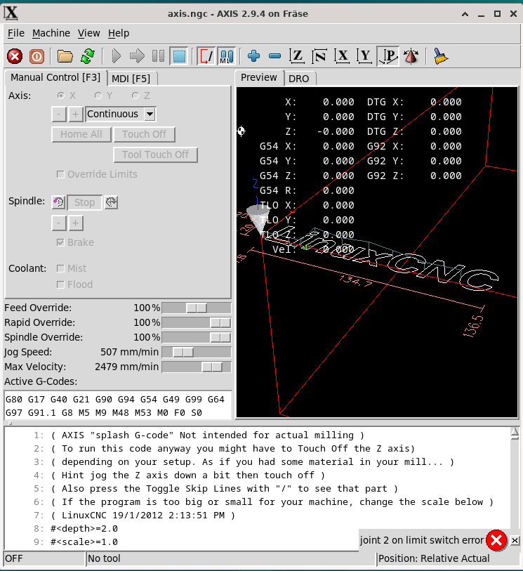

i get the "Joint 2 on limit switch error". I have a Mesa 7i76e and you can find my configuration for Joint 2 attached.
I tried several things but still with no success.
Please help
Please help

Final home position from 0 to -3

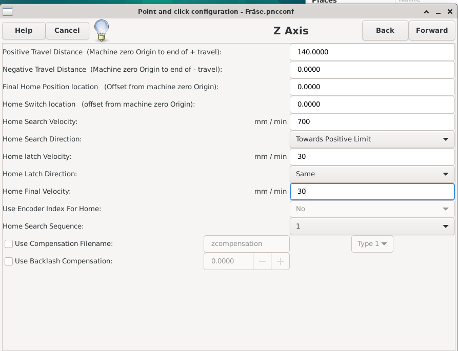

Any Idea why my Z Axis won´t home anymore? I changed the negative travel distance. But before i noticed that i can´t change some values anymore -> see attached file

-1mm might not be enough to move off of the switch so try -2 or -3.
If it still does not work, try 2 or 3.
Also, hoome sequence should be 0 for Z axis so it moves up before other joins/axis start homing.

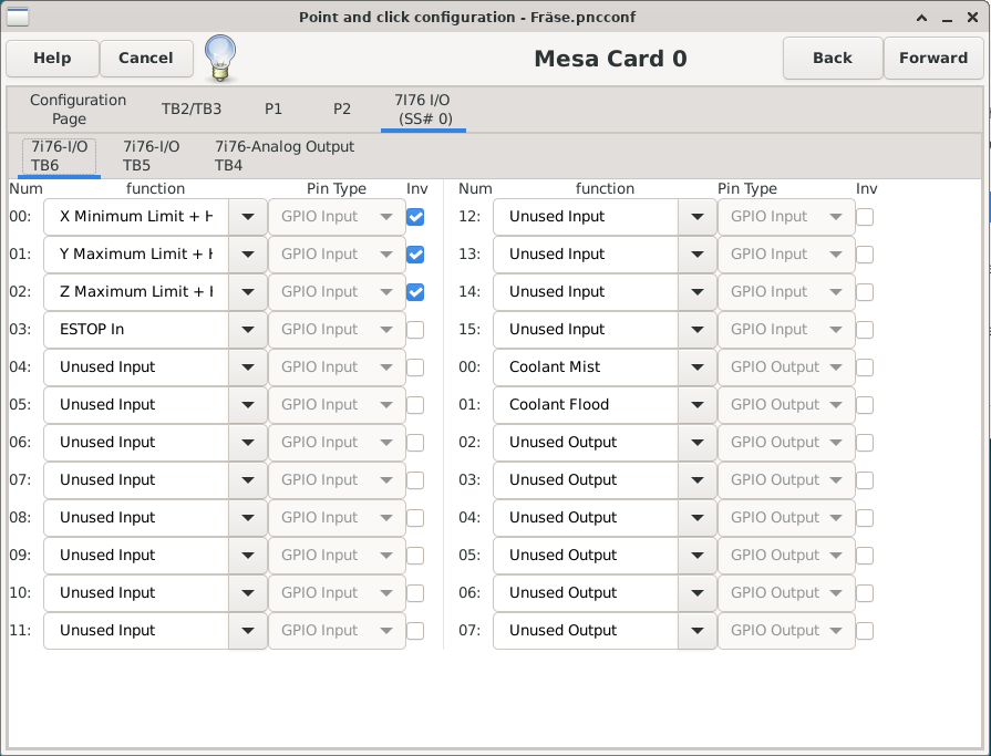

There was "A Maximum Limit + Home set" instead of "Z Maximum Limit + Home"
