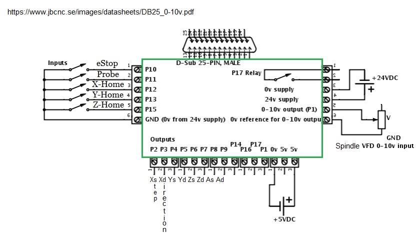

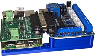

My SetupRaspberry Pi 5 8GBByte2Bot Parallel Port Raspberry Pi HatByte2Bot 5 Axis CNC Interface Adapter Parallel Breakout Board For Stepper Motor DriversPicture 1My wiring is as follows:Picture2

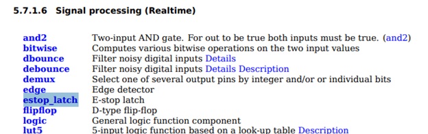

The motors move, the home switches register as functioning, the probe is not hooked up and the eStop appears to do nothing.From LinuxCNC V2.9.7 Documentation PDF Page 1854.9.3.7 External ESTOP button The standard_pinout.hal file assumes no external ESTOP button. For more information on an external E-Stop see the estop_latch man page.Yet from 2 pages earlier in LinuxCNC V2.9.7 Documentation PDF Page 183 I see this line in the HAL file:# create a signal for the estop loopbacknet estop-loop iocontrol.0.user-enable-out iocontrol.0.emc-enable-in I assume “man page” is a typo and this is unnecessary if I am trying to connect it to GPIO25. A search of the document looking for “estop_latch” only reveals this on page 254Picture 3So my estop is on pin10, but that is GPIO25 on the Pi 5. I must refer to it as such.In my .Hal file I have the following lines:loadrt hal_gpio inputs=GPIO7,GPIO8,GPIO25,GPIO12,GPIO13 outputs=GPIO5,GPIO6,GPIO11,GPIO9,GPIO10,GPIO23,GPIO16,GPIO17,GPIO19,GPIO20,GPIO21,GPIO22,GPIO24,GPIO26net estop-out <= hal_gpio.GPIO25-in ornet estop-ext <= hal_gpio.GPIO25-in Using tools I can identify that all my limit switches are being read, but I have nothing to suggest the estop is being read.I have added“Addf gpio-input servo-thread” as recommended by ChatGPT, and that is not read by the programThe advice I am looking for is:

Undo everything ChatGPT suggests and never ever use it again for anything related to Linuxcnc.
Far better to visit this thread
forum.linuxcnc.org/47-hal-examples/25861-external-e-stop#26684
You may have to invert the estop signal, as when you press the estop you are providing a 0v signal. You may also need to check whether the inputs to the estop are tied hi or low when the Estop is pressed.

If I use the following code which has the one missing dash error that I corrected:
# estop
loadrt estop_latch
addf estop-latch.0 servo-thread
net estop-loopout iocontrol.0.emc-enable-in <= estop-latch.0.ok-out
net estop-loopin iocontrol.0.user-enable-out => estop-latch.0.ok-in
net estop-reset iocontrol.0.user-request-enable => estop-latch.0.reset
net remote-estop estop-latch.0.fault-in <= parport.0.pin-in-10-not
The bug-a-boo for me is how do I tie the GPIO25 to the remote-estop. Do I change the last line to:
net remote-estop estop-latch.0.fault-in <= hal_gpio.GPIO25-in-10-not

Depends on what the machine has for an e-stop chain and that is wired, but for small machines that can not do much harm, a simple and single input and a single output are all that is needed:
# --- ESTOP-EXT ---
net estop-ext <= [HMOT](CARD0).7i84.0.2.input-14
net estop-ext => [HMOT](CARD0).7i84.1.1.output-08
That will just loop back the e-stop signal from the button to whatever is connected to the output pin. This works perfectly well on most machines (example is from my 3.5 ton Mazak lathe) as the output is wired to existing e-stop loop on the machine.
That will not allow the machine to come on when the button is pressed and will allow enabling the machine when button is reset.
E-stop latch should be used only when more logic is required by LinuxCNC, and/or more inputs and outputs.
