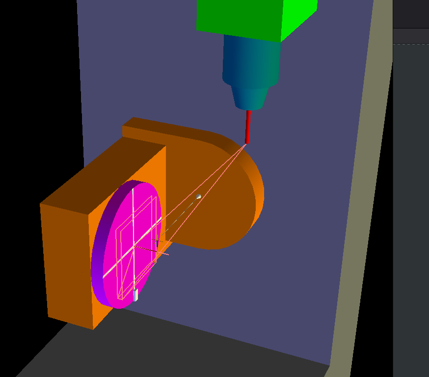

If you want a vismach model to run the code and have the tool path rotating with the part have a look at:
configs/sim/axis/vismach/5axis/table-dual-rotary
This is an XYZAB kinematic with A being a work side rotation (for your purpose you can simply ignore the B axis and the 'TCP' mode):
GEOMETRY = !AXYZNote that the above option cannot handle offsets.
See this thread for more:
forum.linuxcnc.org/10-advanced-configura...axis-display?start=0
Last edit: 09 Jun 2026 14:44 by Aciera.

09 Jun 2026 17:56 #346999
by currinh
Replied by currinh on topic XYZA Simulation Install Problems
YES. I finally found a simulation model, sim.axis.wrapped-rotary, using XYZA. I added the line GEOMETRY = !AXYZ to [DISPLAY] and the axis display acts as it should for a rotary table on A. The "!" did the trick.
I loaded the vismach axis sim model. The axis display has the same problem as above, I'll try the "!" fix which I expect will also work here. The vismach display does function as I expected, moving part with table(s).
These should work for me. Thank you very much for the help. I will have to change units to inches and the envelope size of the machine before my code(s) will run. Also figure out how these simulations implement tool offsets. But thanks to you I see a light at the end of the tunnel.
THANK YOU!
THANK YOU!
- currinh
- Posts: 70
- Thank you received: 3
09 Jun 2026 18:05 #347000
by currinh
Tommy: I finally found one as "sim.axis.wrapped-rotary". If you, or others, know of more I'd like to hear of them. But you're not missing anything I see, it's more my search skills that are missing.

- Posts: 22004
- Thank you received: 7489
10 Jun 2026 02:20 #347007
Replied by tommylight on topic XYZA Simulation Install Problems
Beside what Aciera and you already found, there are several under Vismach section of Axis GUI, gmoccappy and QtDragon have some for 4 and/or 5 axis, WoodPecker also has some.
