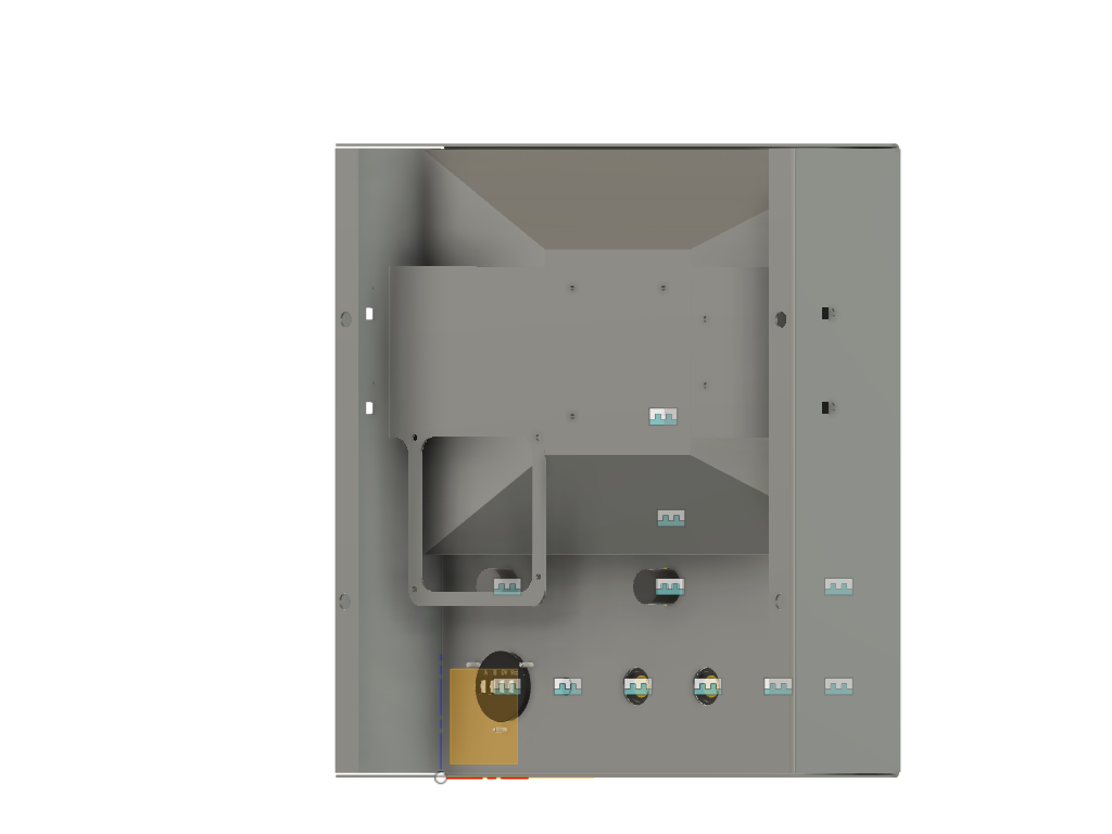

27 Sep 2020 13:38 - 27 Sep 2020 13:40 #183979
Replied by rodw on topic Control Panel Design for PlasmaC
This is as far as I got tonight but basically just got the back cover to go.
So a brace bolted to the monitor's 75 x 75mm Vesa mount holds it in place. It is then held in place by bolts through the case via two alignment slots.
This brace has some bolt holes to mount a 7i73 on the right (two are visible). The square hole on the left is to mount the Odroid to. I think I will need to make the enclosure deeper to allow room for the Odroid so I will end up with the enclosure being about 100 mm deep. I'd love to make it shallower but then the console section below the monitor would need to be made larger to give it some room. The back will be held on by some nutserts and I want to try to use some keyhole shaped holes so loosening 4 bolts will let the front just slide off to be serviced. The back will have some VESA bolt patterns to mount it to a monitor stand or a post as shown by Pinder..
If anybody can find a good CAD file of an Odroid H2, please give me a link. The ones I found had mounting brackets and stuff on them so I just measured up the holes.
EDIT: Maybe the Odroid can be mounted a bit lower above the MPG to keep it slim..

- pinder
- Posts: 196
- Thank you received: 128
27 Sep 2020 14:25 - 27 Sep 2020 15:36 #183982
by pinder
Any reason why you use odroid?
Replied by pinder on topic Control Panel Design for PlasmaC
Last edit: 27 Sep 2020 15:36 by pinder.
- Posts: 11990
- Thank you received: 4084
27 Sep 2020 20:28 #184027
Any reason why you use odroid?[/quote]
Well, they are a full PC in a really small small form factor that have good latency and 2 x NIC so in my view perfect for Mesa and an enclosure like this. BeagleBrainz has a full ISO that includes the network driver thats not in the normal distros yet (too new)
