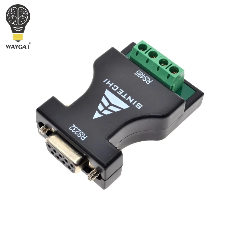

I just want to ask.
For arc-voltage sensing will it not be fast enough? After some study, USB is a big no-no.
Can we use modbus for more io?
update:
can we use this?
USB is the problem or serial communication?
Replied by pinder on topic What should an open source plasma cnc controller have ? At what price?
Not real time, so no reason to bother with.
I just want to ask.
update:
can we use this?
Last edit: 15 Oct 2020 15:42 by pinder.

And yes ModBus can be used for more IO but again not real time.
A much better way would be to use ESP32 as IO and use multiplex/demux to a parallel port, that would still remain in the real time domain.
Replied by tommylight on topic What should an open source plasma cnc controller have ? At what price?
Not really, USB has very bad latency and very often does nothing for long periods of time, having another device on a USB HUB will mess up even more that latency as every USB HUB has two shared ports.
I just want to ask.
