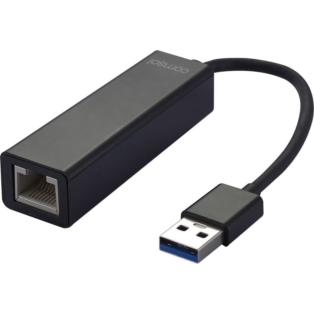

- thefabricator03
- Visitor
18 Dec 2020 04:09 #192299
by thefabricator03
Replied by thefabricator03 on topic Beginners Question on Ethernet with Mesa
As long as you have a spare USB port you can add another Ethernet port for internet.
