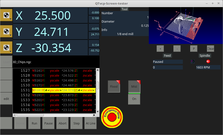

Replied by cmorley on topic Introduction: ArtSoft / Mach3 forum drove me here
Here is a _working_ rough trial in qtvcp - just with font and images I had on system.
Looks like I need to add label LEDs to more closely duplicate your design.

26 Jan 2021 14:18 #196662
by Etaoin
Cool! That looks promising. Steady on though, because I'm already working on an updated version which more closely matches a typical LinuxCNC screen. No huge differences, just a few new buttons and changed wording on others. Quite a challenge getting the new elements to fit, but I'm getting there slowly. You might want to use that XML as your base instead... Will post screengrab in a mo, just gotta tidy up a few things!

26 Jan 2021 14:22 #196663
by Etaoin
Replied by Etaoin on topic Introduction: ArtSoft / Mach3 forum drove me here
Could someone enlighten me; is "ABS" and "REL" the same as G53 and G54 coordinates? Many LinuxCNC GUIs I looked at for inspiration include both ABS/REL selectors and coordinate system switching - is this really needed?

- Posts: 7368
- Thank you received: 2181
26 Jan 2021 15:00 - 26 Jan 2021 15:01 #196665
i would think you should switch to a toolkit that linuxcnc actually supports before spending a lot of time tweaking your code.
Linuxcnc's toolkits use special widgets for many functions that makes coding much easier.
If you build a screen completely with plain widgets you will have a lot of cranky python code to add to make it work.
