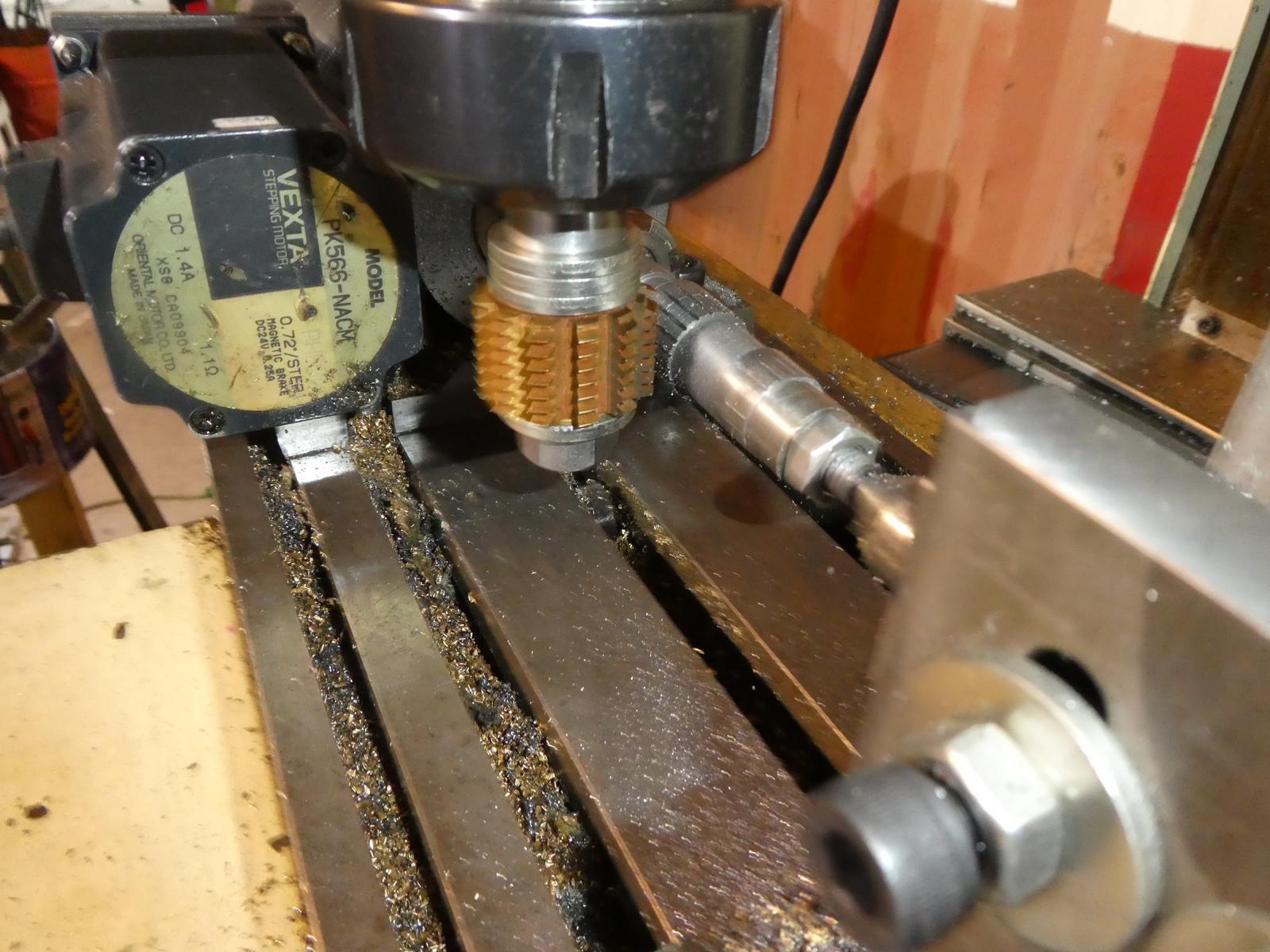

If that counts, to me the "odd machine" is my small gear hobber. After buying a 2nd hand hob and trying to use it I fell into the rabbit hole.
There should be some effort to make it more userfriendly. I still have to change some parameters in the .hal to get it to work, based on the gear at hand.
Andy Pugh provided the necessary help to get it up and running.
