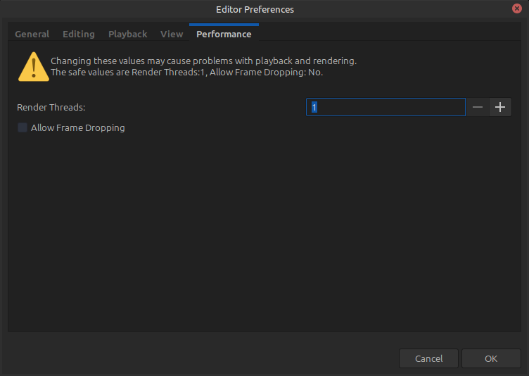

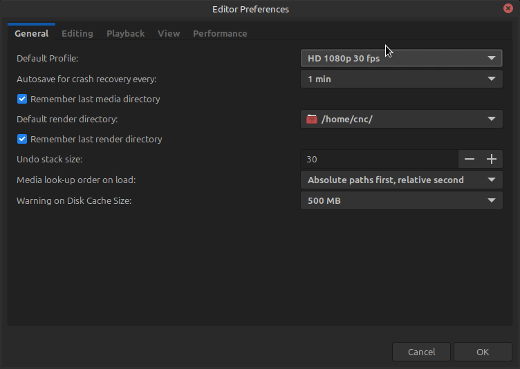

I'm using Simple Screen Recorder to make my tutorials and the resulting video is good quality but when I edit it in Flowblade the video is not good quality after uploading to youtube.
This one is straight from Simple Screen Recorder and uploaded to youtube.
After processing in Flowblade and uploading to youtube the quality is 480 max.
Any ideas on how to get better quality videos to youtube?

Replied by tommylight on topic Video Editors
Edit menu, preferences, see screenshot and choose what you want as default.
Then on the last tab, set the number of threads to use for rendering, i do 5 as i have a 6 core AMD and leave one free for other tasks when using the PC, you can do max number of cores (not processor threads).
Also, use OBS-Studio for screen capturing, it is much better and uses less resources, although your original video is quite OK on a 34" monitor.
