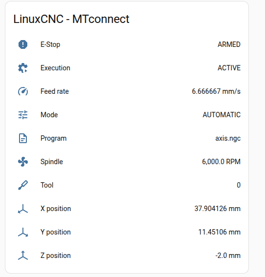

- Posts: 12174
- Thank you received: 4155
31 Jul 2026 04:40 #348276
Replied by rodw on topic Livestream Discussing LinuxCNC and MTConnect 27 July 2026 11:00am GMT+10
Yes its pretty cool. His repo is here github.com/sliptonic/linuxcnc/tree/feature/mtconnect-agent
I've added this link to the video description (and installed it on my machine including a Home Assistant panel)
I have asked in another thread if anybody has a 3 axis vismach model we could use in our PR to linuxCNC
The next step is to discuss with the devs how best to package this. My thought is to have a userspace driver that you added to your Hal file something like:Because all parameters are contained in the ini file, I think this approach will require passing the ini file name to the driver.

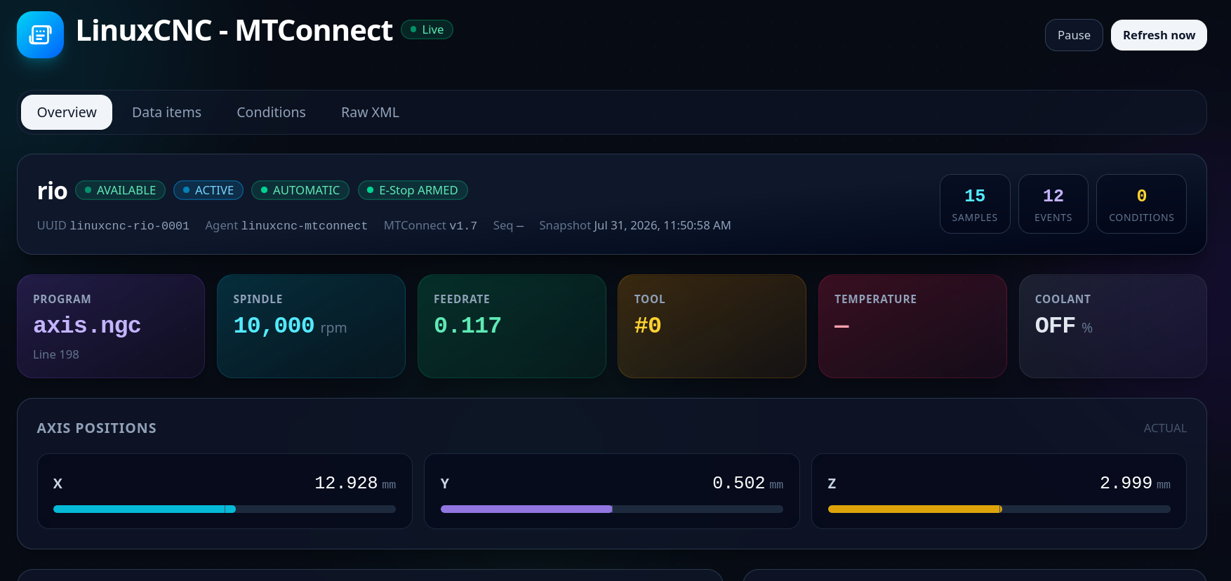

31 Jul 2026 04:49 - 31 Jul 2026 04:57 #348278
by meister
Replied by meister on topic Livestream Discussing LinuxCNC and MTConnect 27 July 2026 11:00am GMT+10
I've already found the repo, but it would be better if it were separate from the LinuxCNC source—that's what I meant by having its own repo.
It would also be cool if you could pass in additional HAL signals, like sensors or 'door-open' inputs.
EDIT:
My first AI project (A simple status page for MTConnect):
github.com/multigcs/riocore/blob/dev/rio...nect/files/stat.html
to test it, you can simply overwrite the twin.html file with it.
EDIT:
