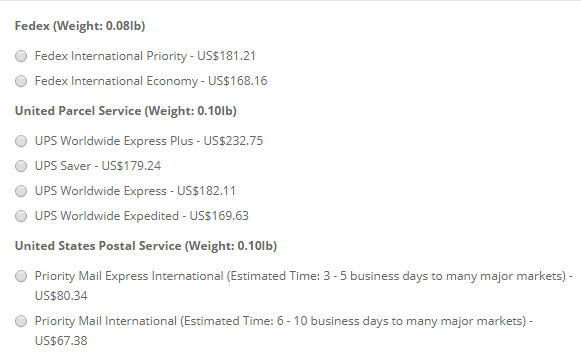

as per title:
THCAD-5 source? {reasonable shipping}
tried store.mesanet.com/
gulp!
THCAD-5 not listed on:
mesaus.com/?s=THCAD&post_type=product
Or
eusurplus.com/index.php?route=product/se...rue&description=true
suggestions... any way to modify a THCAD-10 to become a THCAD-5?
thanks in advance
rob

I ordered mine in the US from MESA with a 7i96, the shipping is very very expensive, got some heavy jeep parts for way less than that !!!
BTW i'm in France
And maybe, check the schematics, the difference from 5 to 10 is only the resistors ?
BTW i'm in France

The only difference is R14 (24.9K 0.1% in -5 49.9K 0.1% in -10)

I bought my other Mesa stuff from mesaus site and at least there is a snail mail option which is available at $29 ish which I'm happy to pay
Tax is tax .... You get hammered on imports from wherever so Portugal or the USA makes no difference
Much appreciated

Those shipping charges seem faintly ludicrous.
It is sometimes worth looking at duzi:
www.duzi.cz/shop_cnc/index.php?main_page=index&cPath=1
But they don't have the THCAD either.
Shipping can be somewhat cheaper, though it might take a lot more effort on the part of the vendor:
www.parcelmonkey.com/quick-shipping-calc...e5-a989-0c1deb1198ee
