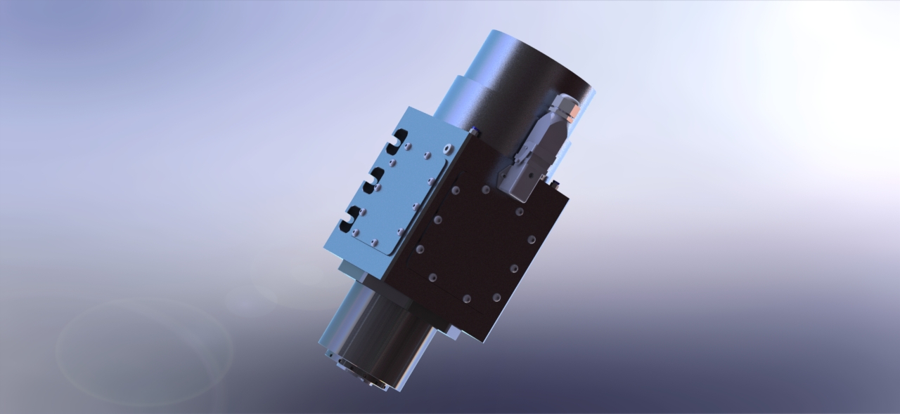

For sales electrospindles for bt30/iso30/nbt30 holders with automatic tool change, water cooling and threading/positioning encoder.
The electrospindle is intended for milling machines, plotters, etc.
Power 1.5kW, 50Hz, 1500rpm, max speed 12000rpm 400hz, min speed of work 100rpm, min speed for orient 20rpm.
It is equipped with;
-Bearings front 2x7009, rear 2x7007 both P4 ABEC7
-Blowout of the spindle cone when changing the holder
-Water cooling with the option of connecting from the front or top
-Three sensors - the holder is attached, the holder is missing and the holder is pressed out
-Contactless front labyrinth seal
-Encoder for positioning/tapping
The force holding the cone is about 3500kN, and a pressure of about 7bar is needed to loosen it.
The project includes two versions, long and short.
The long version is intended for umbrella magazines, where the height of the holder and the height of the magazine and its closure must fit when changing the tool.
The short version is intended for rack magazines used, for example, in plotters.
There are also versions with or without driving bt30 stones on the front.
Encoder resolution maybe chose on order from 512ppr to 3278ppr interpolation factor 1-2-4-8-16-20-25-32-64
Electrospindle easy thread steel with M10 tap, max spindle torque is 12Nm.
Long model price is 3000Euro.
Short model price is 2800Euro.
Plus shipping from Poland.
More info in a private message..
