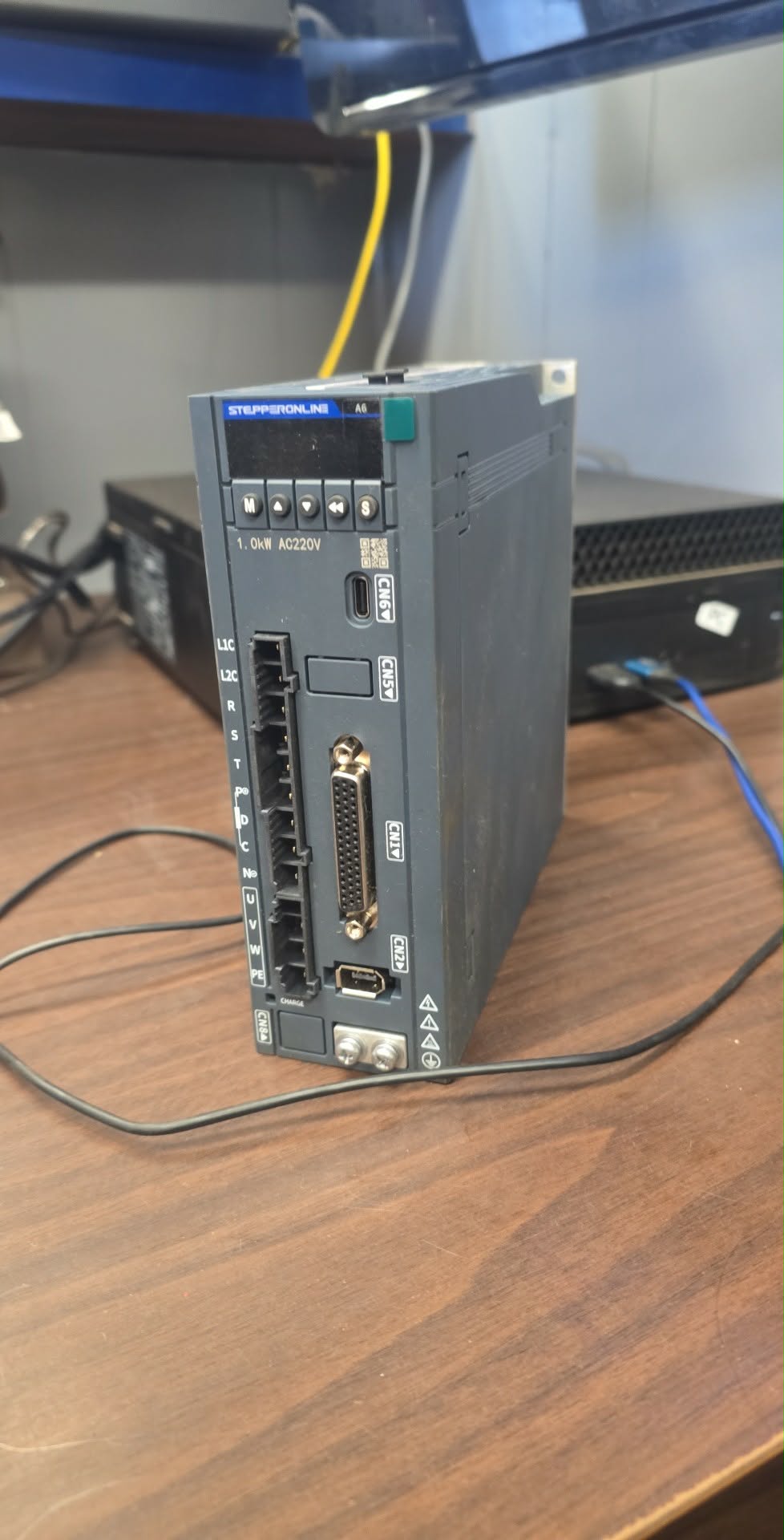

23 Dec 2025 20:40 #340436
by tcbmetalworks
Replied by tcbmetalworks on topic Looking for a freelancer to assist in drawing schematics for cnc plasma table
I included a photo below of the servo drives I already purchased. We have them mounted on the gantry already. here is a link to them. www.omc-stepperonline.com/a6-series-1000...-ip67-a6-rs1000h2a1-
The following user(s) said Thank You: NWE
