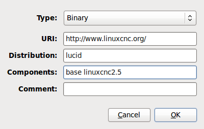

The 10.04 LiveCD with LinuxCNC 2.5 had a small issue that might have affected a few people when installing and this has been corrected. If your installing LinuxCNC make sure your iso file is ubuntu-10.04-linuxcnc3-i386.iso (note the 3 after linuxcnc is the latest one).
If you installed from the LiveCD using ubuntu-10.04-linuxcnc2-i386.iso in order to get updates you will have to open the Synaptic Package Manager and go to Settings > Repositories > Other Software tab and change the edit the EMC entry's to reflect the re-branding change as shown below.
John
John

i did that on the repositories (i have already installed ubuntu with the live CD) EMC2 2.4 works fine.
but the actualization does not appear

If you want to run on Lucid it is possible. Many people are doing so.
buildbot.linuxcnc.org
Replied by andypugh on topic 10.04 LiveCD README
Yes. For a long time there was no version of RTAI that ran on the newer kernels. This remained true for so long that the decision was made to not require RTAI any more, and LinuxCNC can now run on Xenomai or RT-preempt too. Part of this work also introduced the ability to compile for ARM (Beagle Bone and Raspberry Pi). The hope is that the new system will be portable enough to be distributed without a LiveCD, as juat another package (sudo apt-get install LinuxCNC)You know this project needs a recompile! ubuntu 10.04 is already rather dated
Yes. People have been working _very_ hard behind the scenes. But it has been so much work that the system is not ready for a LiveCD yet.last post over a year ago. anybody still working here?
