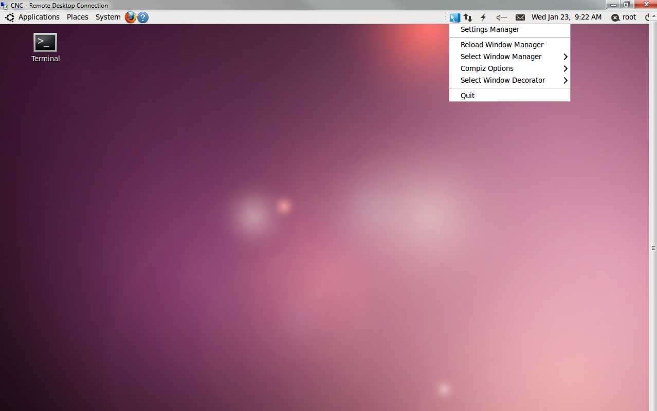

I just downloaded and installed LinuxCNC then Googled around and found all the applications needed for remote access, here is my list:
## NOTE: my machines are behind a firewall, all local access is secure behind locked doors
## My Windows based machines are Windows 7 and XP
## I named my computer CNC during the install
## First get the user root to work
sudo -I
passwd root
## logout and login as root
## now get a ssh server up for remote access, install the wrapper for unknown WiFi devices, install a
## RDP server for windows to remote access the server and then install file sharing
apt-get -y install openssh-server ndisgtk xrdp samba

Update: Has an issue with the screen saver not working:
## I tried adjusting compiz by installing a manager
apt-get install compizconfig-settings-manager
## that didn't work, screen saver still would not function
## Fix the screen saver issue
Apt-get install fusion-icon
## Then select Metacity was the windows manager seems to fix it

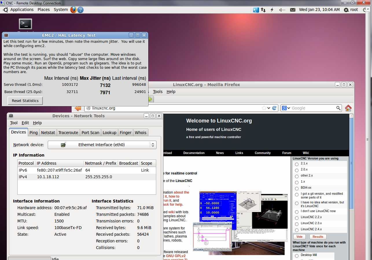

It was a lot of googling to get all the parts but it was worth it; now I sit in my computer room on my workstation with my 32" monitors, twin quad 3.2Ghz Xeons, I can use Microsoft's Remote Desktop Connection tool to control my LinuxCNC box as it sits in the shop at 35 degrees!

I think you can do all this already with LinuxCNC.
(Lots of different ways to do it, depending on exactly what is required)
Here is something I often do when running a long job, I create a little window on the Mac in my living room that keeps my apprised of whether the mill is still running or needs a toolchange / has finished.
1) Connect to the CNC controller from the Mac2) Open a halmeter to monitor a useful HAL pin
As long as the numbers keep changing, the machine is running. When waiting for a (manual) toolchange or when finished, the value goes to zero.
Using ssh -Y and running "linuxcnc" from the Mac terminal I can have the entire CNC GUI on the Mac rather than on the controller, but that is rarely useful (might be OK with a camera in the workshop). Alternatively remote-desktop can be used to display the CNC screen on both computers.
ssh -Y andypugh@mill.localhalcmd loadusr halmeter -s pin motion.program-lineAs long as the numbers keep changing, the machine is running. When waiting for a (manual) toolchange or when finished, the value goes to zero.
