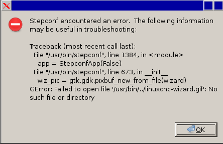

I installed Linux 12.04 on a laptop, removing any other previous installation.
Then I followed the process indicated here : wiki.linuxcnc.org/cgi-bin/wiki.pl?LinuxCNC_On_Ubuntu_Precise
At the last stage, I selected linuxcnc from master-rt. However I tried the other one yesterday (v2.5 branch-rt) and I also got the same error.
As I don't touch or move any file, I wonder if the error is not coming from the source ?
Regards
Regards

Hi
The problem is that this is not an officially supported kernel and packages yet.
It is possible that the buildbot packages are currently screwed.
I helped test the kernel during development quite a while ago, but have not used it since.
I will install 12.04 on a partition and test it and come back to you
regards
regards

Hi
It is not you, there is something screwed in the linuxcnc buildbot packages
I have just installed it all from scratch and I can replicate the error in the buildbot package of the master-rt
However linuxcnc runs, so just use your old config, you should not need to go through stepconf again
I will report it on the users list (Done)
regards
regards

Thank very much you for your great support, it takes time to execute the simulation you made !
OK, I copied my config files, and it seems perfect !
I will now do more than simulations.
Best regards
Yves
Best regards
Yves

Replied by ArcEye on topic PRECISE 12.04
The bug has now been fixed in the master, but apparantly was not found in 2.5?
I don't know how long it takes for the next buildbot cycle to reflect the fix, I'll check in a few days
regards
regards
UPDATE
The buildbot version is now updated (currently xxx.5188.xxx)
Run apt-get update to fetch the new package details, or you will be told you are already at the latest version
Then apt-get install linuxcnc will fetch the latest version
regards
regards

I just retried
It works VERY WELL.
Thank you for your support !
Regards
Yves
It works VERY WELL.
Regards
Yves
