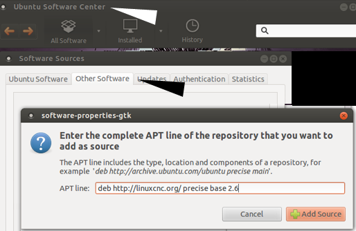

From the left column of the Ubuntu screen, select Ubuntu Software Center (orange shopping bag icon)
Although hidden, move the cursor to the top of your screen and a menu bar will be revealed.
Select the Edit > Software Sources > Other Software
Add this new Apt line:
deb linuxcnc.org/ precise base 2.6
Authenticate and Close.
return to Terminal and, one at a time, copy each of these commands and press return:
