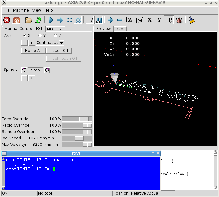

Hi
Now had time to build the kernel and test it, don't know why you are having problems.
1) fetch kernel-3.4.55 from kernel.org to /usr/src/linux-3.4.55
1a) clone rtai
cd /usr/src && git clone github.com/SebKuzminsky/rtai RTAI && cd RTAI && git checkout old-3.9-debs
2) create symlink to kernel sources /usr/src/linux-3.4.55 at /usr/src/~linux
3) patch kernel with RTAI/base/arch/x86/patches/hal-linux-3.4.55-x86-1.patch
4) copy config-3.4-9.rtai-686-pae to /usr/src/linux/.config
5) make menuconfig and set local version suffix to -rtai and processor cores to match
6) make -jN && make modules_install && make install
7) discard the rubbish that GRUB produces and simply have an entry that reads similar to this with disc numbers and UUIDs amended to suit in /boot/grub/grub.cfg
menuentry "sda3 3.4.55-rtai" --class gnu-linux --class gnu --class os {
    insmod part_msdos
    insmod ext2
    set root='(hd0,msdos3)'
    search --no-floppy --fs-uuid --set=root 135dd1b1-0c8b-46f5-9748-94eb75c21eae
    linux /boot/vmlinuz-3.4.55-rtai root=UUID=135dd1b1-0c8b-46f5-9748-94eb75c21eae
    initrd /boot/initrd.img-3.4.55-rtai
Reboot and select kernel 3.4.55-rtai
8) cd /usr/src/RTAI && ./autogen.sh && ,/configure && make menuconfig
Select correct number of cores, enable C99 support
9) make && make install
10) Fetch the latest version of the master
git clone git://git.linuxcnc.org/git/linuxcnc.git linuxcnc-dev
11) Build it
cd /usr/src/linuxcnc-dev/src && ./autogen.sh && ./configure && make && make setuid && cd ../ && . ./scripts/rip-enviroment && linuxcnc
result
regards
