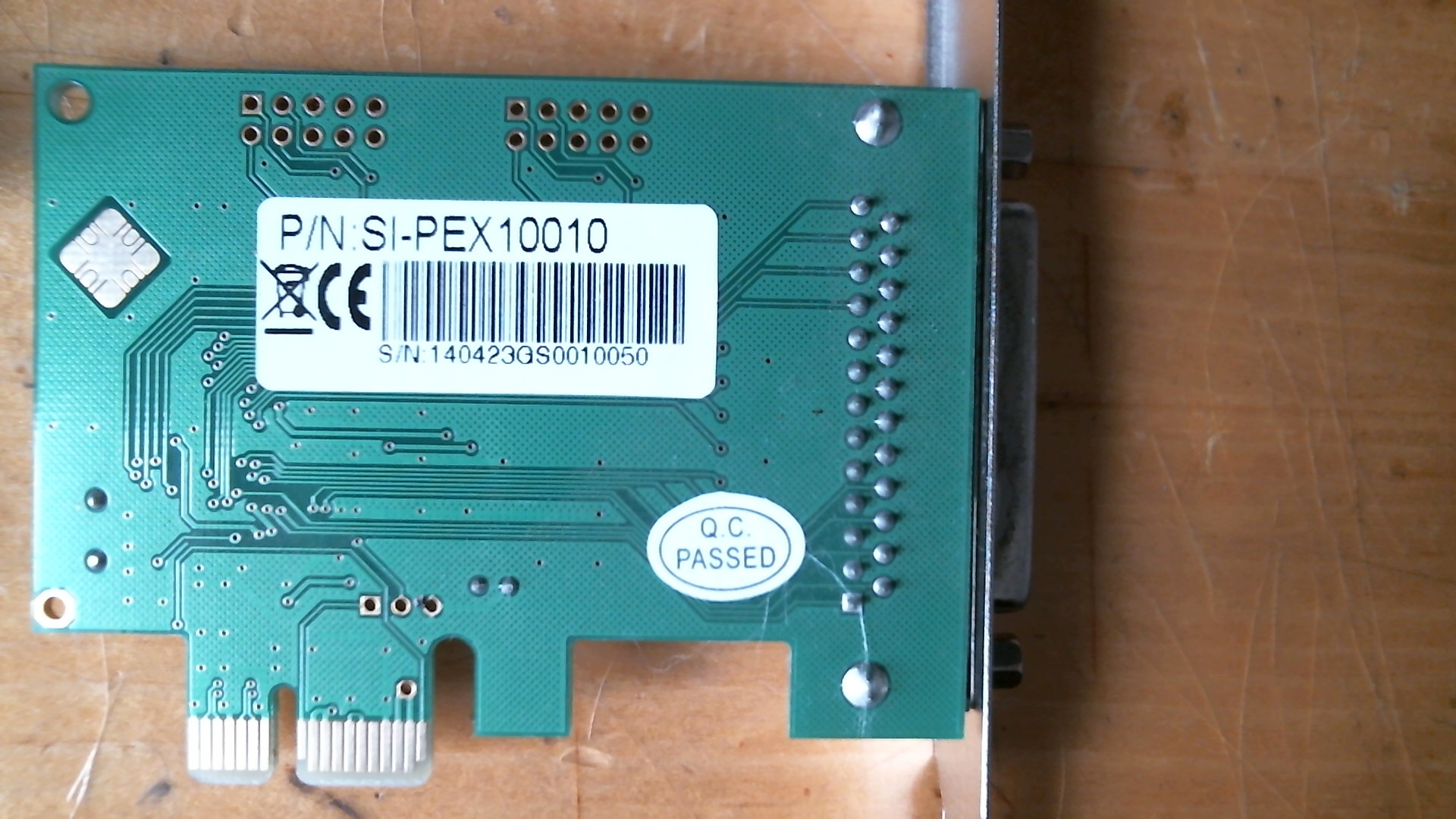

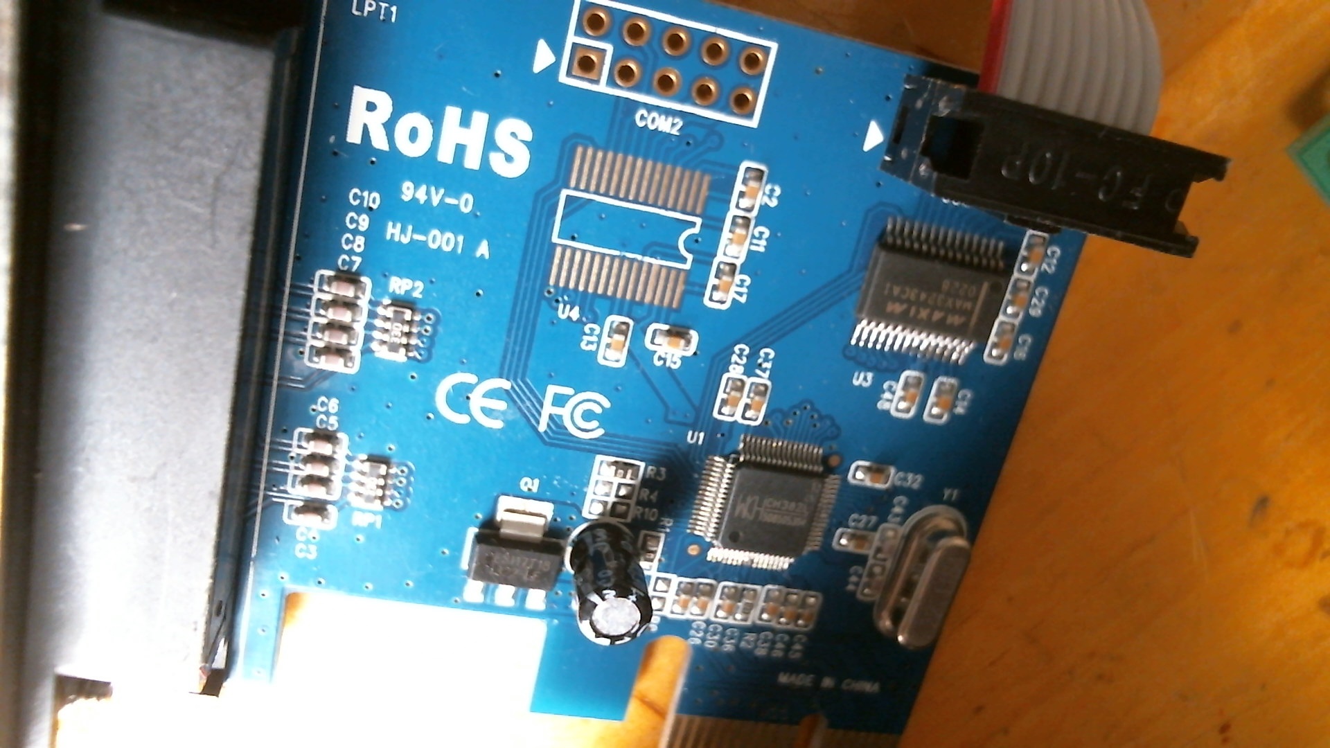

Here is where I am on this computer.
I installed Kubuntu. I probably shouldn't have done this either but the upgrade/install instructions said any flavor should work. This may be adding to the issues.
I cannot get the computer to talk to the machine.
halcmd: loadrt hal_parport cfg="<config-string>"
Error: could not insert module /usr/realtime-3.4-9-rtai-686-pae/modules/linuxcnc/hal_parport.ko: Device or resource busy
<stdin>:8: exit value: 1
<stdin>:8: insmod failed, returned -1
See the output of 'dmesg' for more information.
I had to add /etc/modprobe.d/emc2. manually. Now the file says install parport_pc /bin/true
I still get the busy warning though.
halcmd: loadrt hal_parport cfg="0"
Error: could not insert module /usr/realtime-3.4-9-rtai-686-pae/modules/linuxcnc/hal_parport.ko: No such device
<stdin>:9: exit value: 1
<stdin>:9: insmod failed, returned -1
halcmd:

I didn't read carefully through the whole dmesg output but I don't really know what all I'm looking for.
This did jump out at me though,
[   82.307164] PARPORT: ERROR: linux parport 0 not found
[  204.580138] PARPORT: ERROR: request_region(0xc000) failed
[  686.448347] PARPORT: ERROR: request_region(0xffff) failed

24 Feb 2015 04:31 #56260 by yoshimitsuspeed
Replied by yoshimitsuspeed on topic Trying to get 2.7 working on new machine
I tried the other card today with no luck and same no devices found warning.
One thing I just realized is that card I linked to above is PCI and both the ones I have are PCIE. Could this be the problem?
Otherwise maybe they just aren't compatible?
Attached are pics.
I am just going to order that card I linked to above since it's cheap.
24 Feb 2015 15:37 #56265 by ArcEye
Replied by ArcEye on topic Trying to get 2.7 working on new machine
The first one is Sybausa make with WCH382L Chipset.
It does not claim to be anything but a legacy printing card and they have completely failed to work in the past.
On the second I can ID a MAXIM MAX3243CAI chip next to the header.
That chip is a RS232 transceiver.
I think the other chip, is the same Sybausa CH382, they seem to be called both WCH CH382 and CH382.
So both the same from a manufacturer whose cards have previously not worked.
I don't think there is anything inherently problematic with PCIe, but have never used a parport board for that slot, all my workshop computers are too old.
I will add Sybausa cards to my list.
regards
