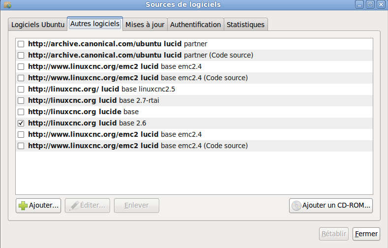

For updates to 2.5 to 2.6 and to 2.7 I have exactly followed the
instructions in linuxcnc.org:
Update: "source software"
then update "Synaptic Package Manager"

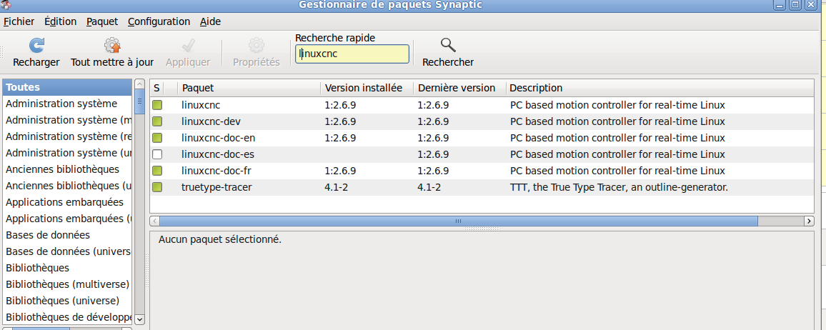

Question: for your debugging control "dpkg "
I have to reinstall 2.6.9 or 2.7.0 ?
Thanks!

Thanks for all your debugging attachments. They show that your system has the right packages installed, plus the mystery linuxcnc.so in the wrong place that's breaking your upgrade.
I ran "make install" in our 2.5 branch (with the -n flag, so it didnt actually copy anything), and it wanted to place linuxcnc.so in /usr/lib/python2.6/dist-packages, exactly where yours is. I think someone (maybe not you) ran "make install" at some point, and that's why upgrades are broken for you now.
I think your options are to try to remove the accidentally installed non-package files by hand, or wipe your system and reinstall. We are deep in dangerous territory now, but this shell script will run for a long time and then show all files in /usr that are not owned by any debian package on your system. You could try removing them all and see if that makes things better. I'd opt for a reinstall myself.
