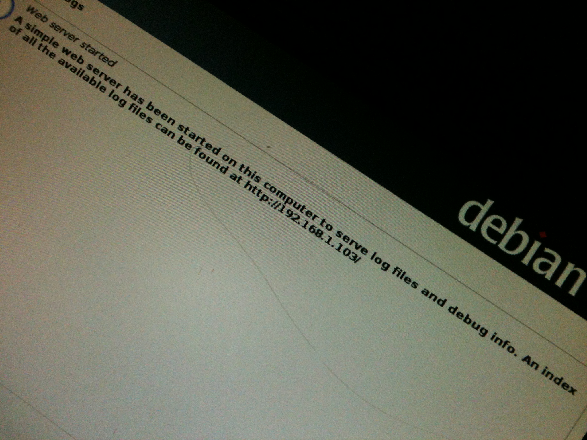

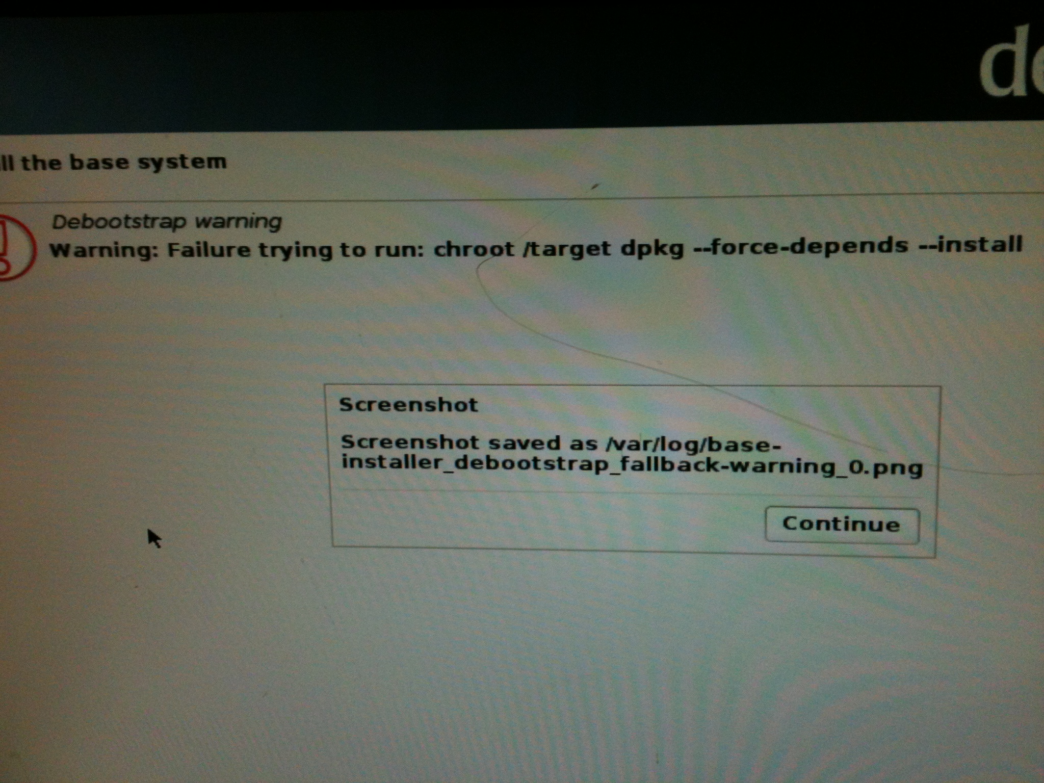

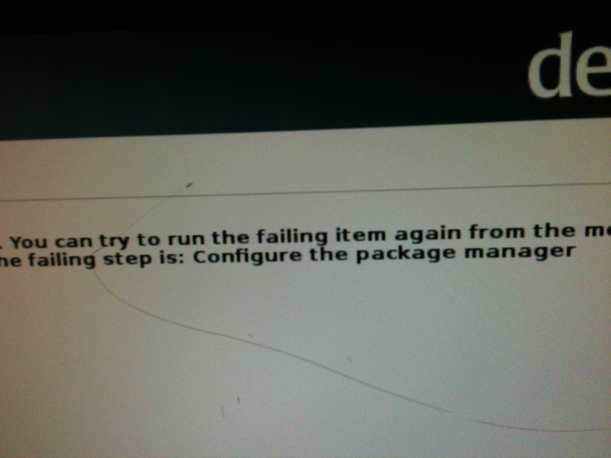

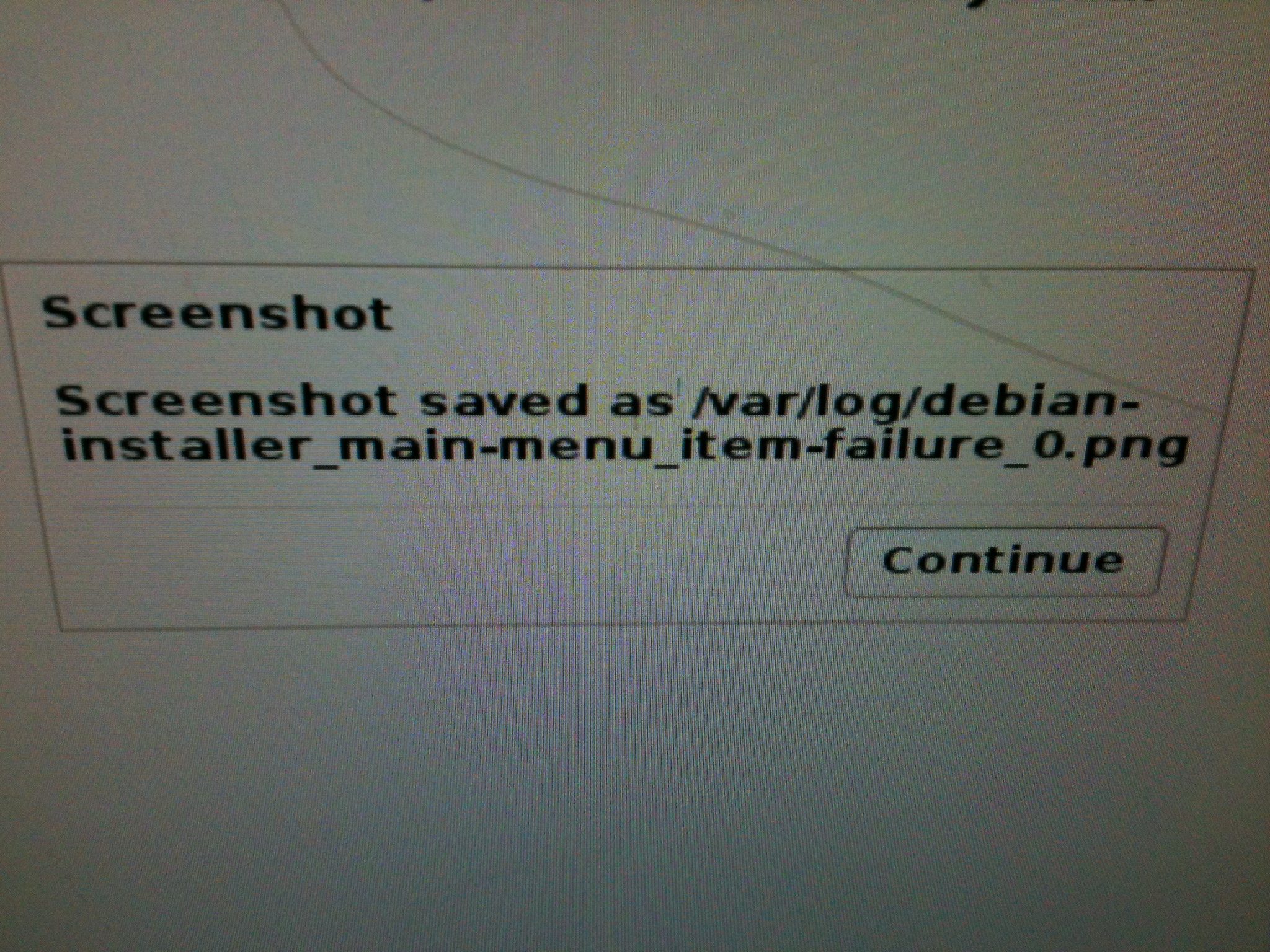

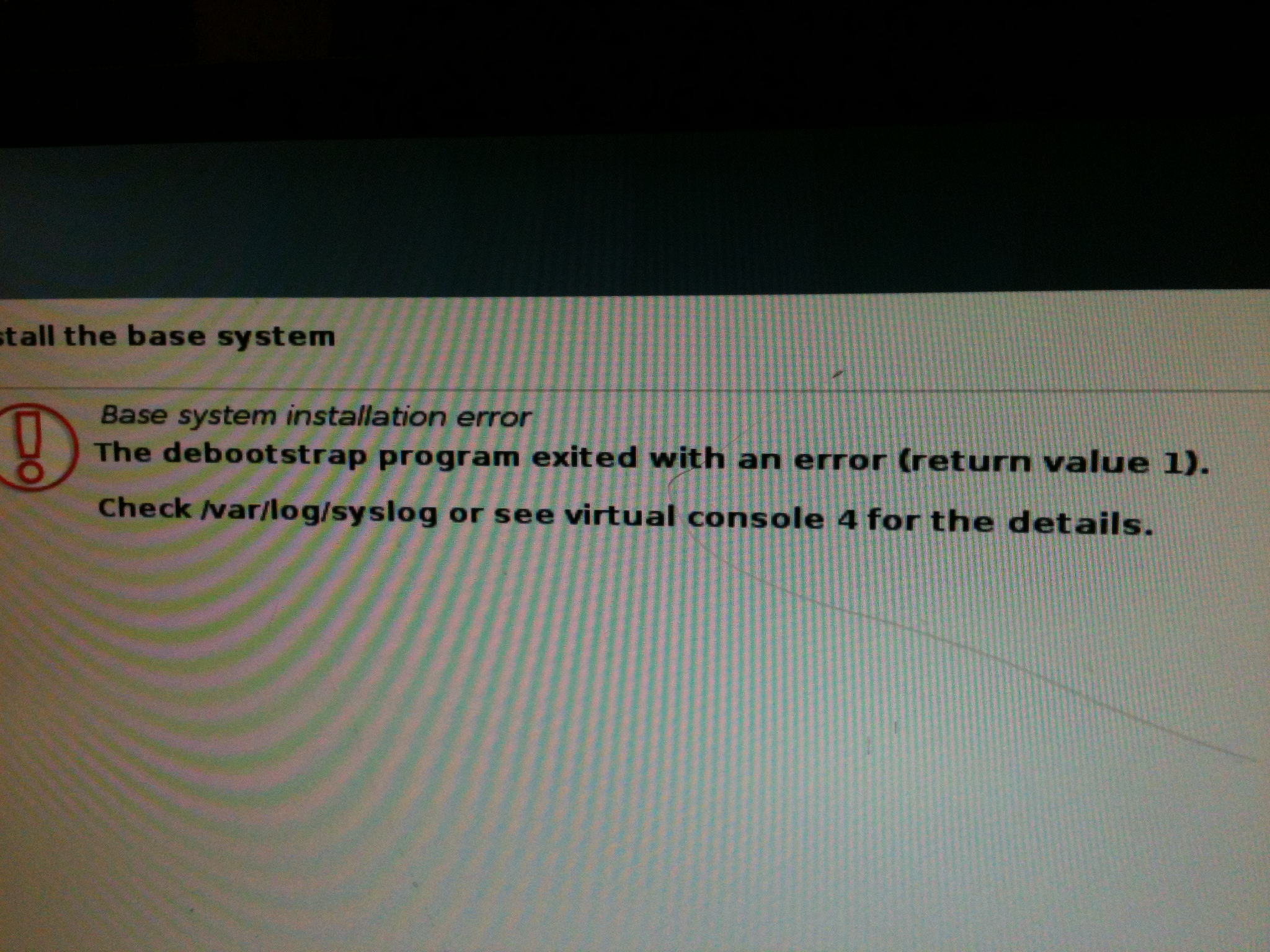

sorry for the delay had to move photos around and reboot to check computer specs.
i took these photos with my phone
when i tried again to install and tried to continue without installing the system
to see what happened.
i don't think i have a specific point it happed at maybe 1/3rd of the way through.
it was at the graphical install step installing the system.
I'm not sure what else i can tell you.
maybe you can tell me how to find the info you looking for.
computer is a dell dimension 4700 3.2ghz 2.5GB 500GB hard drive.

Dell Dimension 4700 (Pentium 4 3GHz, 512MB RAM) looks like a pretty old computer so I'd say Ubuntu 10.04 is your best bet. Just upgrade to 2.7.
wiki.linuxcnc.org/cgi-bin/wiki.pl?UpdatingTo2.6
linuxcnc.org/docs/html/getting-started/updating-linuxcnc.html
JT
