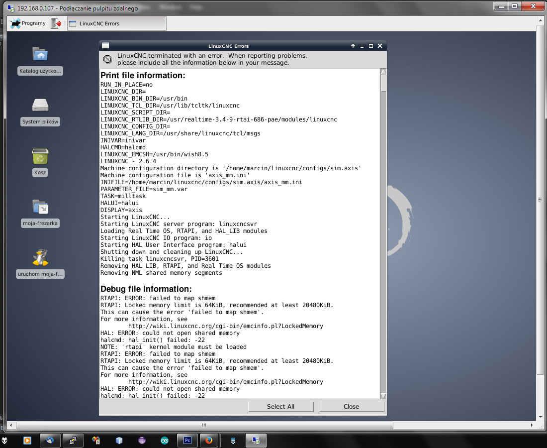

VNCserver or XRDP. Problem. was created by exxo

16 Oct 2015 10:34 #63805
by cncbasher
Replied by cncbasher on topic VNCserver or XRDP. Problem.
check the link shown and make sure you have 20480 ( i have mine at 30000 )
your running low on memory .

16 Oct 2015 11:02 #63807
by exxo
Replied by exxo on topic VNCserver or XRDP. Problem.
did not help
