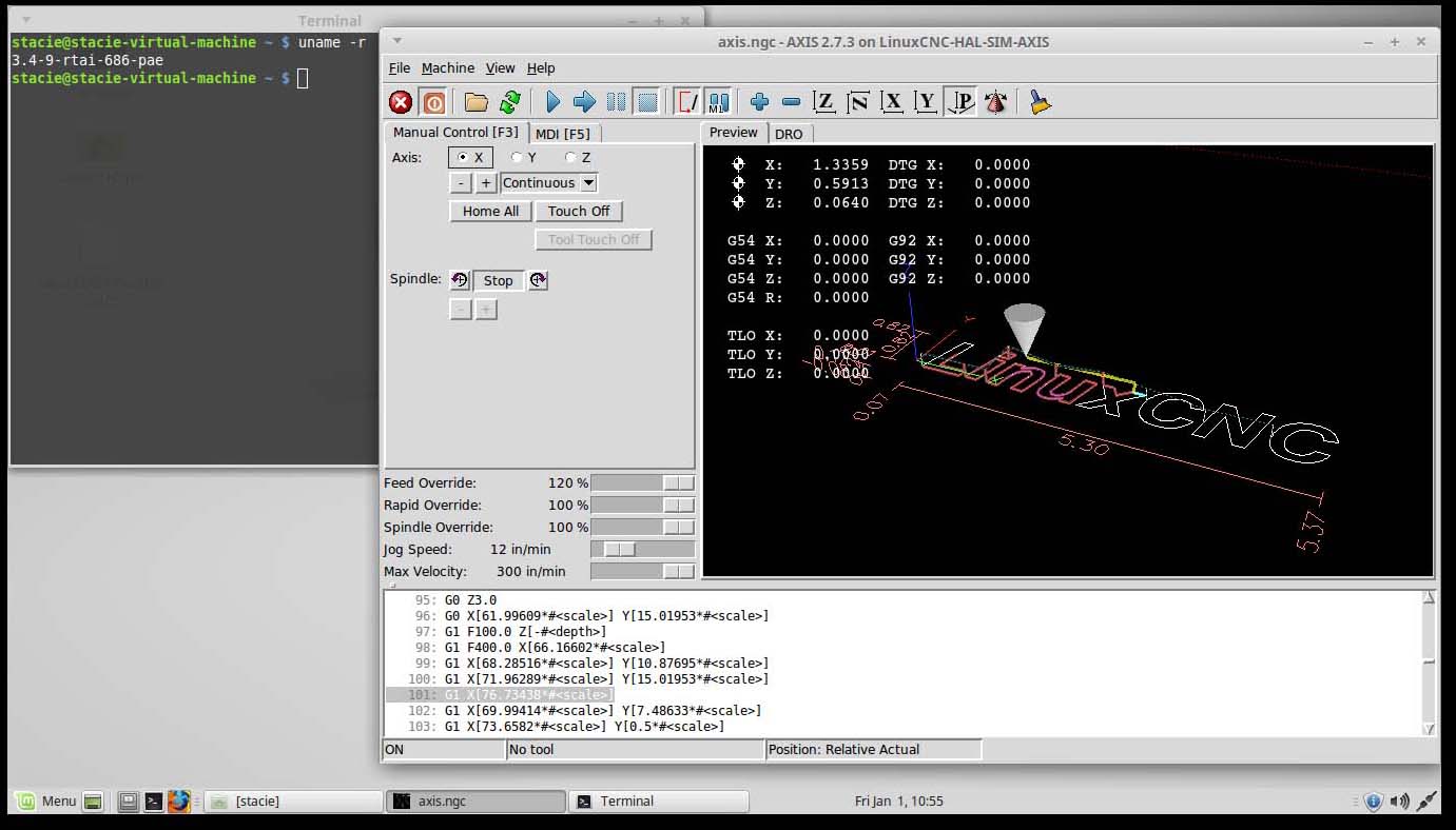

Hey Guys!
Its a new year and I'm trying to figure this out. I'm not sure if it is critical or not. Being a newbie sucks!
I followed the readme posted by tjmarch to the letter multiple times, however I still haven't been able to get the menu to populate as demonstrated in other post-installs, posted to this thread. I have done about 10 clean installs without upgrading anything and this is still my outcome. I did not notice any errors or anything out of the ordinary.
Any help would be most appreciated! Let me know what I need to post to help with troubleshooting. I haven't been on Linux since 2006 and have forgotten most of what I knew.
Linux Mint 17.2 [MATE (32-bit) using 3.4-9-rtai-686-pae kernel
I have axis working in sim mode using RTAI for testing, but I'm sure I'm doing something wrong
It seems that I have a permissions issue. I had to run as administrator for the first run.

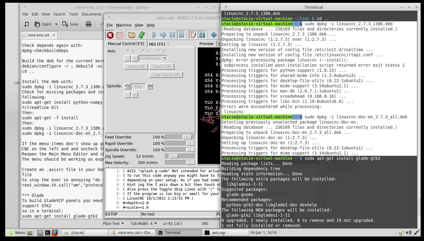

01 Jan 2016 14:21 - 01 Jan 2016 14:30 #67661
by cncnoob1979
Replied by cncnoob1979 on topic Linux Mint with RTAI
JT,
Just finished the installation and went very smooth. However while installing the deb I did get a error.
Did you get the same on your install? Otherwise everything worked and the menu fix was spot on. Thanks for the help brother! I hope things go this smooth when I install on my mini atx motherboard.
Installing new version of config file /etc/linuxcnc/rtapi.conf ...
dpkg: error processing package linuxcnc (--install):
subprocess installed post-installation script returned error exit status 1Did you get the same on your install? Otherwise everything worked and the menu fix was spot on. Thanks for the help brother! I hope things go this smooth when I install on my mini atx motherboard.
Last edit: 01 Jan 2016 14:30 by cncnoob1979.

01 Jan 2016 17:04 #67666
by BigJohnT
Replied by BigJohnT on topic Linux Mint with RTAI
I don't remember an error like that but if your up and running ignore it! Now if I can figure out why my image is not showing up...

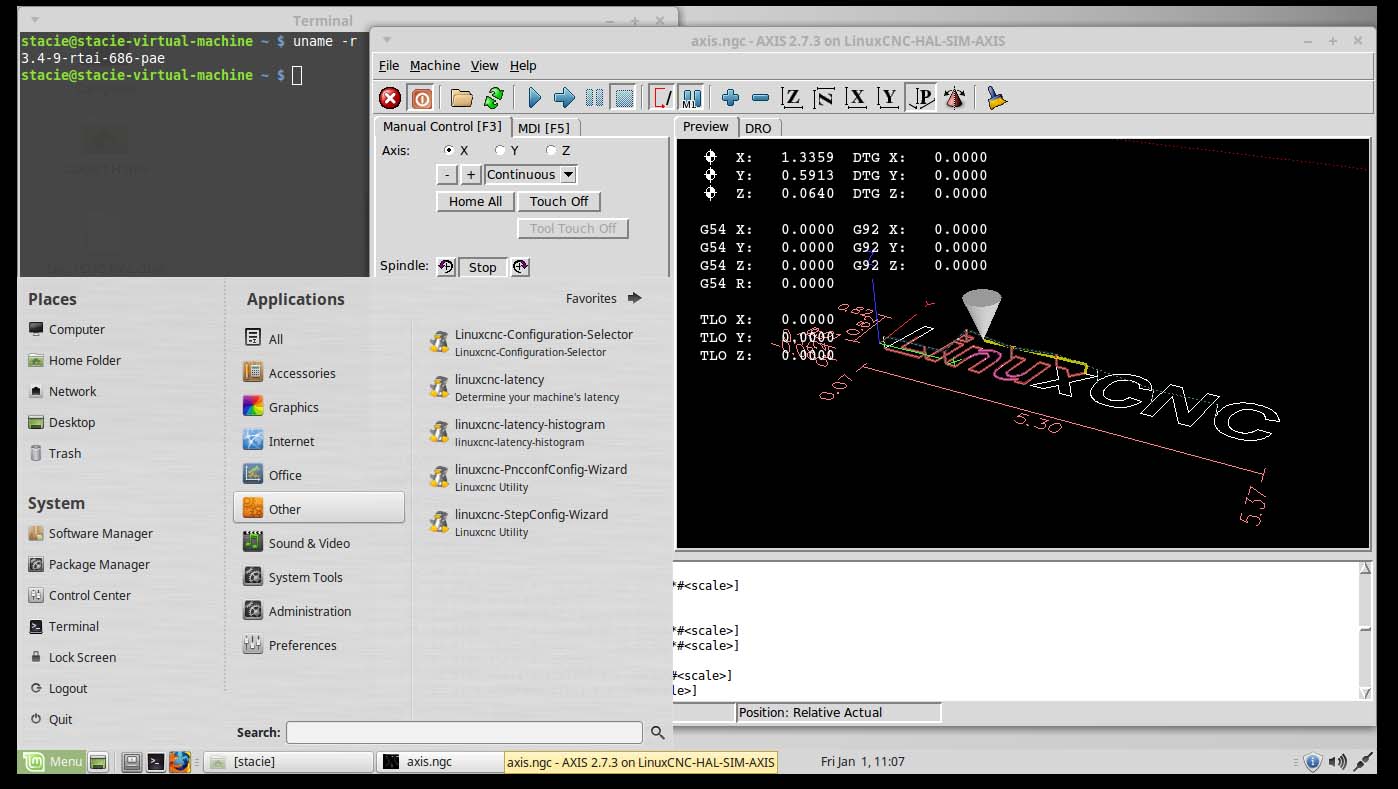

- Posts: 19904
04 Jan 2016 07:51 #67821
Replied by andypugh on topic Linux Mint with RTAI
For some reason you seem to have "LinuxCNC Configuration Picker" rather than "LinuxCNC" but I am fairly sure that they do the same thing.
- cncnoob1979
- Posts: 403
- Thank you received: 75
04 Jan 2016 09:16 #67833
by cncnoob1979
Sorry Andy I'm not following your statement. Linuxcnc configuration picker vs Linuxcnc?
Are you saying with my above configuration I have the configuration picker open?
I'm running the sim mode to verify the install procedure. How would I tell either way, or how could you tell?
- Posts: 19904
04 Jan 2016 09:19 #67835
In the second image of #67655 I see a menu item "LinuxCNC Configuration Selector" which I suspect has the same function as the "LinuxCNC" menu item that you said was missing.
Or I might be completely confused. It happens a lot.
