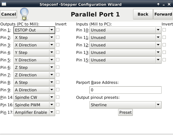

Hello everybody. I am testing linuxcnc 2.7 on Virtualbox 5 ( I have 2.6 installed on virtualbox and works fine ) but after finishing stepconf when I tried to lunch linuxcnc I get an error and it not start.
the error is:
"Error: Could not insert module /usr/realtime-3.4-9-rtai-686-pae/modules/linuxcnc/hal_parport.ko: No such device
./my-mill.hal:6: exit value: 1
./my-mill.hal:6 insmod for hal_parport failed, returned -1"
I am using an image downloaded from the ofiicial page. I don't understand why it not happen whith the previus version (linuxcnc 2.6)
I am going to use this machine as a simulation not in production.
Thanks.

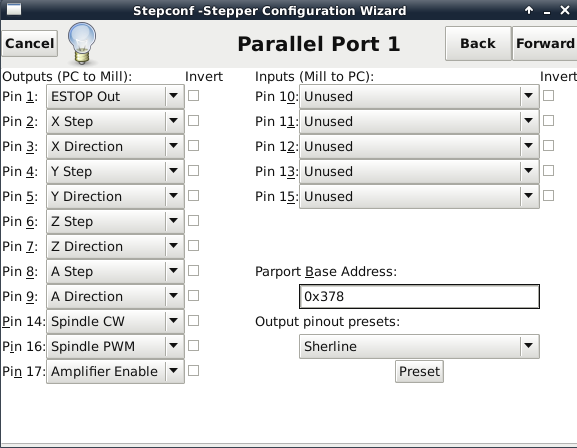

- echesortux
- Posts: 46
31 Mar 2016 07:28 #72460
by echesortux
Replied by echesortux on topic Errors in linuxcnc 2.7 on starting up
Hello folks I could solved the problem. the problem was that there is a slightly differente in stepconf wizard in the new version (2.7) in parport base address it has a 0 by default so that is you don't have a physical parallel port it will fail but if you change that value to 0x378 the gui starts without problem.
attached are screenshot.
Thanks everybody for helping.
