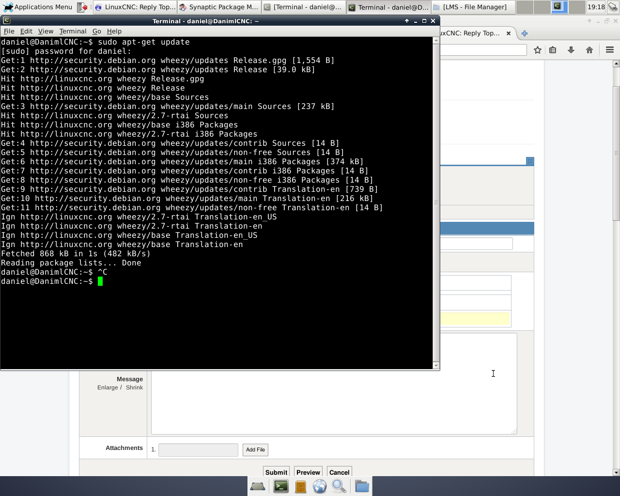

06 Jun 2016 13:10 #75570
by BigJohnT
Open a terminal and type:
sudo apt-get update
it should tell you what to do to fix the broken packages.
JT

- danimal300
- Posts: 54
07 Jun 2016 20:29 #75666
by danimal300
Replied by danimal300 on topic upgrade from 2.6.5 to 2.7 will not install
I ran the command you posted. I think that I have done that in previous troubleshooting.
Attached are screen-shots of the results.

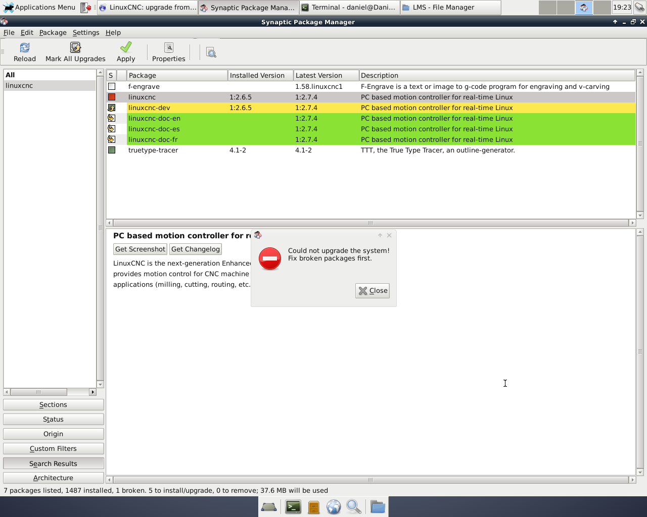

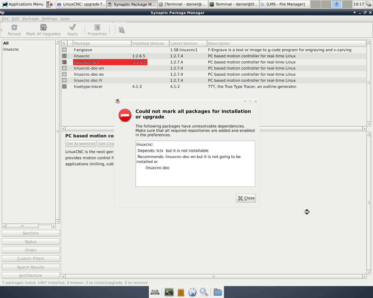

- danimal300
- Posts: 54
07 Jun 2016 20:34 #75667
by danimal300
It will not let me remove the packages, and it will not let me change anything. it gives basically the same errors, and claims dependencies.
Here is another screen shot when I tried to manually mark each individual piece of the package.

08 Jun 2016 01:50 #75671
by cncbasher
Replied by cncbasher on topic upgrade from 2.6.5 to 2.7 will not install
you have broken packages that your trying to install , this is shown in red
so remove or deselect this package first
make sure that you have buildbot.linuxcnc.org and the approprate version you require from
listed in your repository list in synaptic package manager
( see wiki for further details )
then run sudo update && upgrade

- danimal300
- Posts: 54
09 Jun 2016 08:40 #75726
by danimal300
I clicked the mark for removal, and it said that it could not be removed because Linuxcnc 2.6.5 depended on it.
How do I remove it?
How do I remove it?
