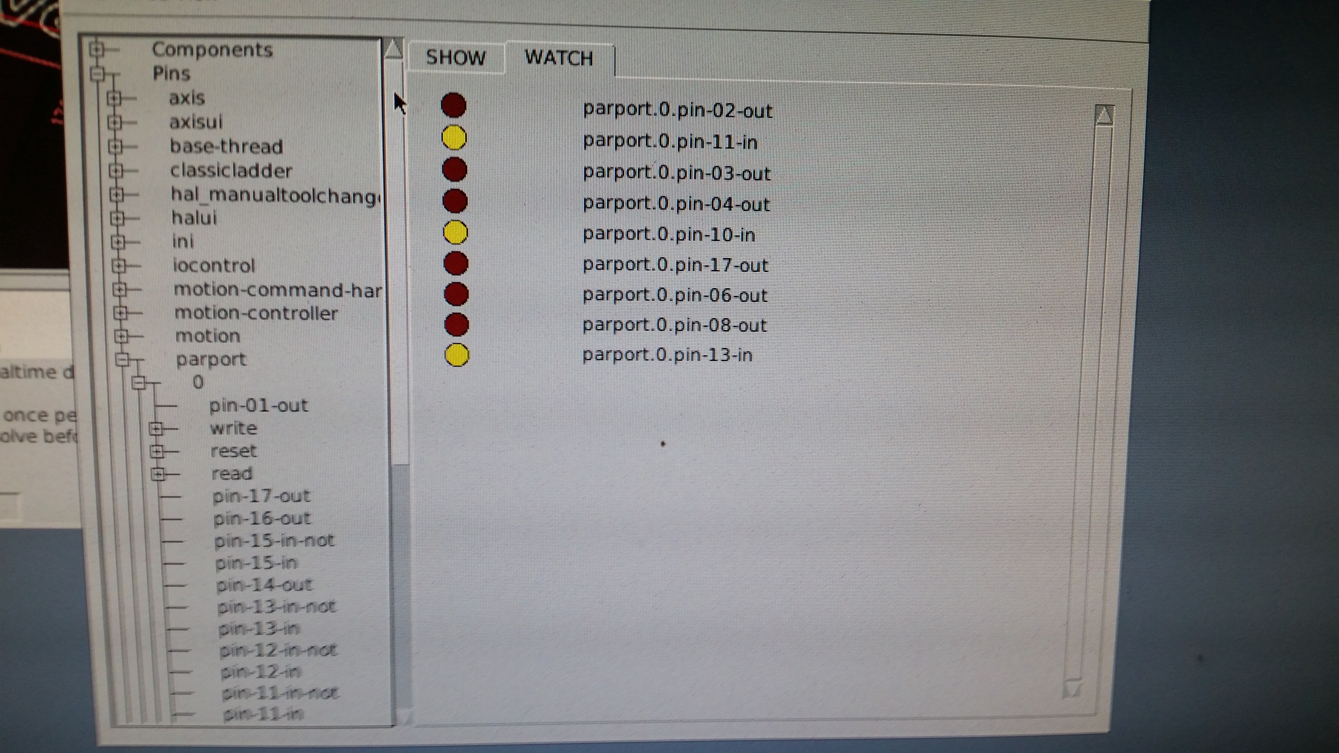

So, it looks like the drives are enabled. I think the next thing to check is if the parallel port is working.
Do you have any inputs wired up the BoB? You can observe those in the "Watch" tab of halshow. (In Axis you can get to that from Machine->Show HAL Config, otherwise open a terminal window and type "halcmd loadusr halshow"
If you can see the state of some parallel port pins change when you toggle input pins then that indicates that the parallel port is configured and working. If you can't see that it doesn't necessarily mean that it isn't, though.
It might be worth switching the polarity of the step pulses, that is a check-box next to the pin in Stepconf.

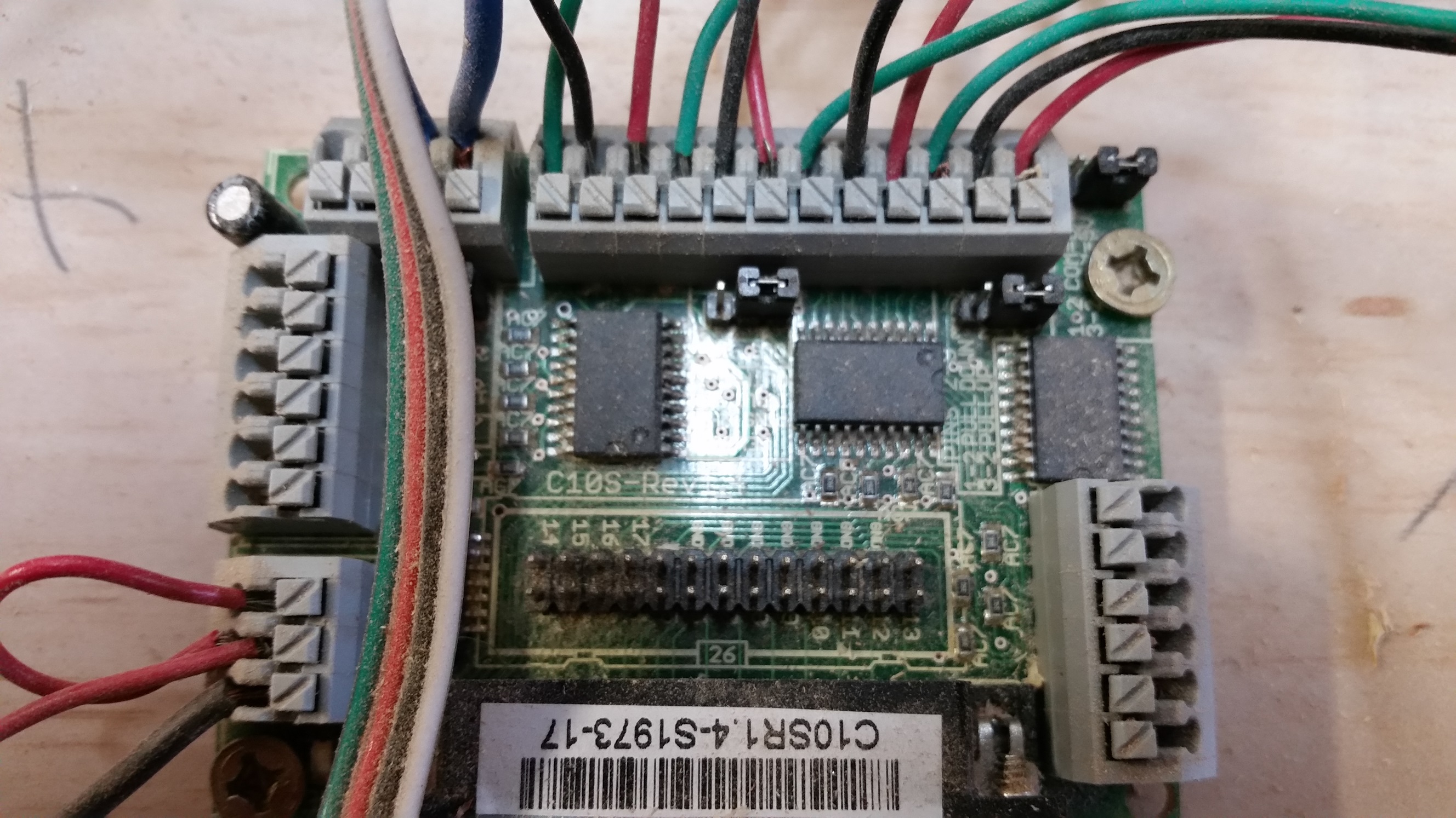

That's my configuration too - C10 with 3x4030s. I got lazy and plugged both y into one driver instead of trying to configure the slave axis.
It's been a couple of years but I remember having the same problems at first - motors locked when I powered the board, but couldn't talk to it with the computer. I think it turned out to be my wiring between the driver and the motors was off, or I'd messed up one of the (2?) pull up/down switches on the C10. If you want to post a pic or description of how you've wired it, I'll take it out to the workshop and open mine up for comparison.

Looks good:
In the interior square part of your board, there are three jumpers spaced out in a row.
The far right one is pullup/down for 2-9 and it shold be on 1-2(pulldown). It looks right in the pic
The middle one decides if you're using 2-9 for input or output. It should be 1-2output, looks right in the pic.
The far left one controls the other ports, which are used for input (probes/limit switches/estop etc). It's set to pulldown on mine.
Looks different:
In your pic - upper right corner is a jumper that sets the COM ports to 5V or ground. It should be 5V. It looks like you've got it set to ground? On mine it's set to 5V and it takes the 5V input on the bottom left of your board and sends it to each 4030 (from the COM to the DIR+, and then the DIR+ and PUL+ are jumpered together on the board.)
Looks different:

Switched the jumper now getting a RTAPI error.
